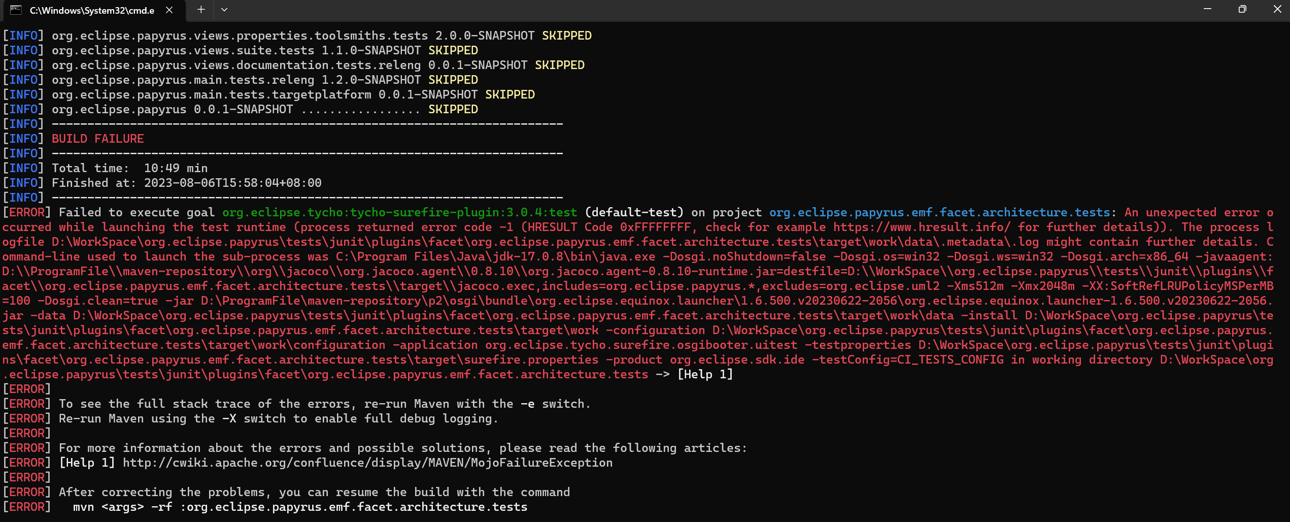

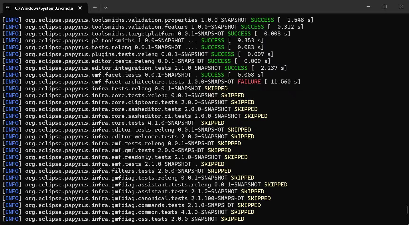

Hello everyone,
I am buildinging the papyrus application through source code, and I got the source code from https://git.eclipse.org/r/papyrus/org.eclipse.papyrus.git, then I executed the command "mvn clean install", but it failed. The log shows that "org.eclipse.papyrus.emf.facet.architecture.tests 1.0.0-SNAPSHOT FAILURE", it seemed that the plugin file (org.eclipse.papyrus.emf.facet.architecture.tests 1.0.0-SNAPSHOT) cannot be obtained? How can I get it? Or I got the wrong version of source code?
thank you!

Re: source code build failure [message #1860661 is a reply to message #1860512] Thu, 24 August 2023 08:03 Go to previous message
a similar question has been asked a while ago. Please have a look at this thread.
In particular, it might be better to compile only a small portion of Papyrus (e.g. a plugin you want to change).
If you still want to compile Papyrus, the README.md file at the root of the git repository may be useful. It's useful to compile only the "main" set of plugins and not the tests using the following maven command at the root of the repository:
mvn clean verify -f releng/main/pom.xml
In the same way, you can compile the tests. If I remember correctly, this requires that you've previously installed the main plugins (via "clean install").
mvn clean verify -f releng/tests/pom.xml
