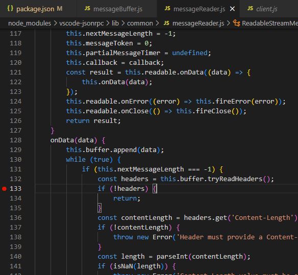

In UI VScode extension is not showing any validation issue.((OutPutStream issue))
Server is IO:
When i debug StreamMessageConsumer :consume() we convert to bytes and write to output stream.I can see data
I put a breakpoint in MessageReader.js to check Vscode client is getting data or not(Image attached).
I don't see data while debugging MessageReader.js seems in between data is lost or got cleared.
All this is happening in first request(initialize). Server is executing validations and etc. But in UI(Vscode Extension no output).
Any input will be appreciated.

Found root cause messageBuffer.js code was throwing error if header not contains :

validation message was having CRLF and it was more than 3 lines. So messageBuffer.js was considering message as header.
I made changes to validation message.
