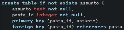

In Windows 10 if I set the IntelOne Mono font the bold words get a different spacing:
index.php/fa/43333/0/
Whereas if the font is Consolas the bold spacing is correct:
index.php/fa/43334/0/

Re: IntelOne Mono font incorrectly rendered [message #1860146 is a reply to message #1860094] Wed, 19 July 2023 10:33 Go to previous messageGo to next message
Ed Merks wrote on Mon, 17 July 2023 11:42
Once installed, can you use it in an application like Word? If if you use it in Word, or some other application that supports fonts, does the bold version of the font have the same spacing/pitch as the non-bold version?
I can use it in any application. The spacing and pitch are the same as the non-bold. It is only in Eclipse that it is different
This is in Word:
index.php/fa/43339/0/
