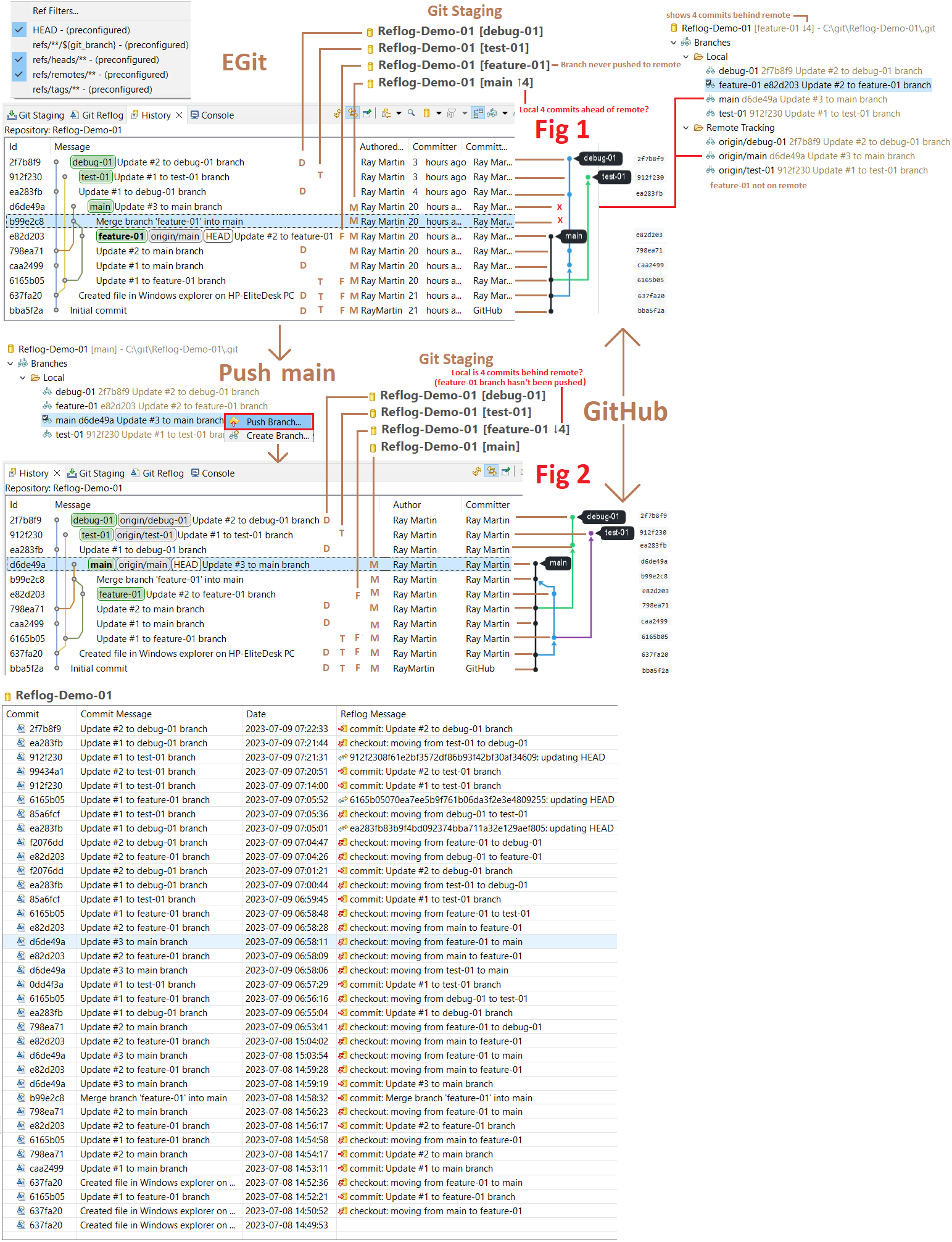

Fig 1 shows History after merging feature-01 into main then doing another commit to main (d6de49a). Staging now says main is 4 commits ahead of the remote. Are these 4 commits the 2 prior commits to feature-01 (6165b05, e82d203) plus the merge commit (b99e2c8) plus the "Update #3" commit (d6de49a)? Please explain.
Prior to pushing main, staging of the feature-01 branch is not ahead or behind. In Fig 2 I pushed the main branch so it no longer has any staged changes but the local feature-01 branch now shows it's 4 commits behind the remote. Why? The feature-01 branch is still only on the local repo (never pushed to the remote). Which 4 commits to the feature-01 branch is staging referring?
I may have forgotten some steps so I also show the Reflog.

I wonder how origin/main ever got to commit e82d. I guess you did push feature-01 after all, and origin/main is the remote tracking branch of feature-01.
The four commits that main is initially ahead of origin/main are (from bottom to top) caa2, 798e, b99e, and d6de. (All commits from main to the merge base between main and origin/main, which is 637f.) origin/main is the same commit as feature-01.
Then you push main, which updates origin/main to that same commit. So evidently now origin/main is the same four commits ahead of feature-01, and thus feature-01 is these four commits behind its remote tracking branch, which is origin/main.

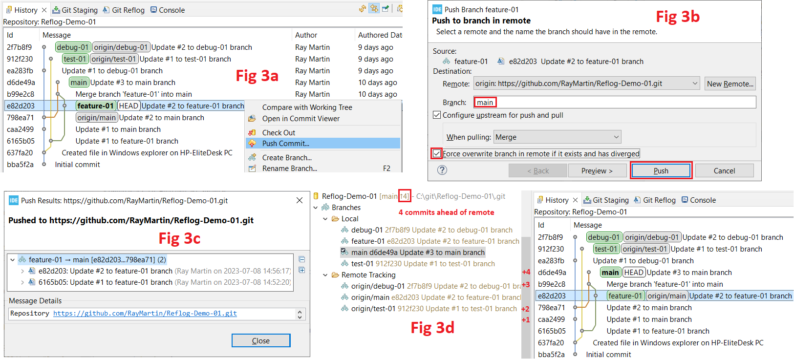

While I was playing with Merge, I just now remembered I also played around with "Push commit..." (to force staging). This could explain how origin/main ended up at commit e82d in Fig 1 without my pushing the feature-01 branch. The 4 steps below and in Fig 3 are probably what I did:
  1. Select the commit you want to be the head of one of the branches on the remote. In this case I selected commit e82d. Right-click that commit and select "Push Commit..."
  2. In that dialog box, enter "main" and check "Force overwrite" then press "Push".
  3. It shows the Push Results.
  4. EGit history now shows origin/main at that commit (which just happened to also be the head of local feature-01 branch).
So, commit e82d, not the feature-01 branch, was pushed to main on the remote. Staging of main is recalculated based on the new origin/main. In this case the local main is now 4 commits ahead and without a feature-01 branch on the remote.
Does that make sense? "Push commit..." doesn't alter the local repo so the Reflog doesn't show that activity. I doubt you can push any commit to any branch in that remote so please explain.

I see that "Push Commit..." did actually use the "push branch" dialog since it detected that feature-01 was pointing to that commit. And the dialog (fig 3b) has "Configure upstream for push and pull" checked, so the remote tracking branch of feature-01 will be set to "origin/main".
Perhaps the menu label could be changed to "Push Branch..." when the command is going to use the "Push Branch" dialog. Might that be helpful?

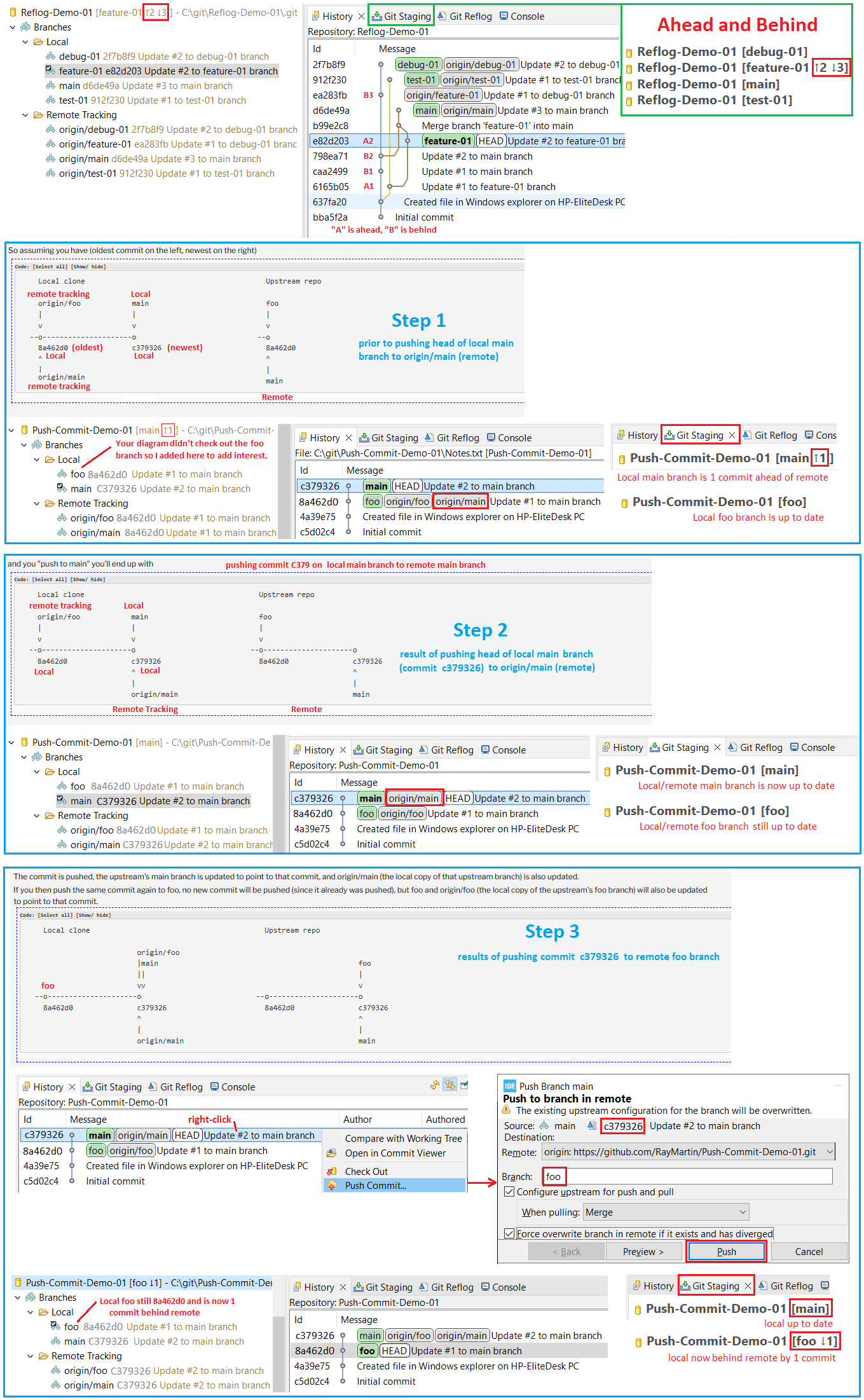

When I earlier mentioned "force staging" or "set staging that's ahead AND behind", that related to the way EGit's "Git Staging" view shows the Ahead/Behind counts. The top section in the latest image below is an example.
To make it easier for me, I translated your text diagrams into EGit format using the same commit IDs. Please verify/correct my diagrams shown in the Step 1-3 blue boxes.
index.php/fa/43452/0/
