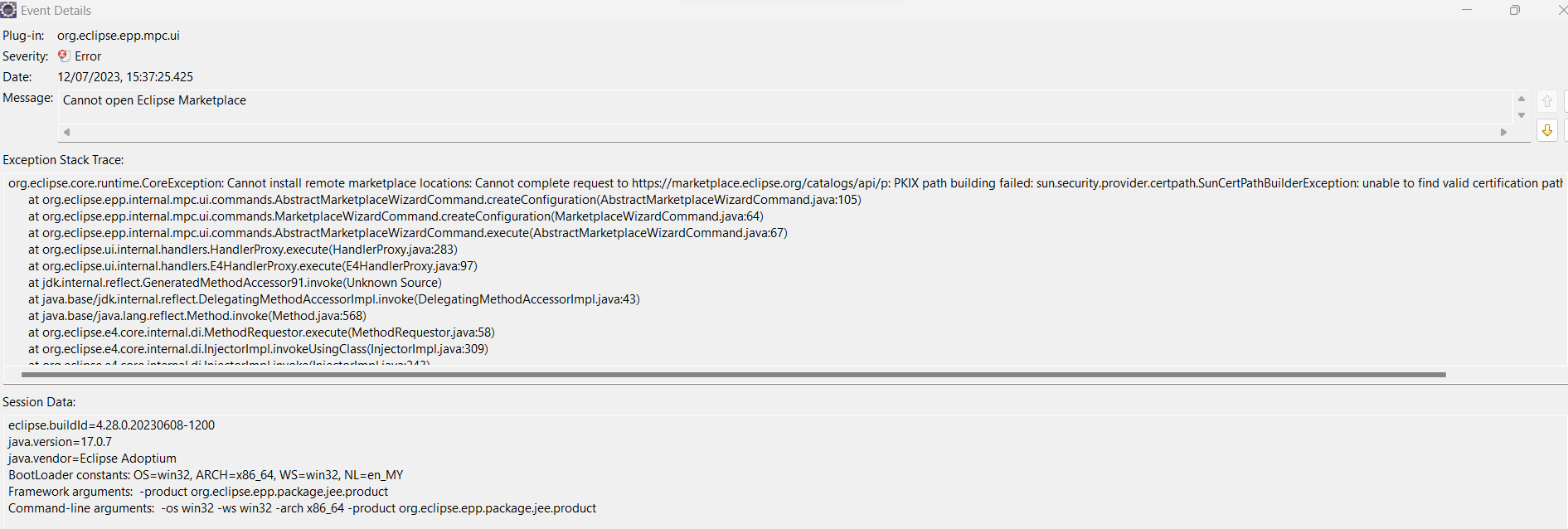

Using Eclipse 2023-06 with Java version 20, the problem now unable to open Eclipse Marketplace, the error as shown in the attached image.

Are you behind a firewall? You could try adding these two lines at the end of your eclipse.ini:
-Djavax.net.ssl.trustStoreType=Windows-ROOT
-Djavax.net.ssl.trustStore=NONE

It shows a "PKIX path" error that is invariably caused by a certificate problem which often happens when you are inside a corporate firewall.
I'm not sure what you are hoping to discover by seeing the picture that would not be better accomplished by describing your problem. You're not able to open this link?
