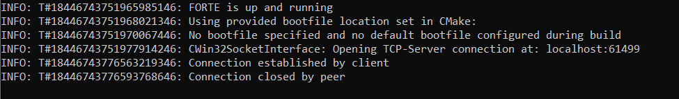

When I run forte.exe it comes out like the first image
Then when I try to put deploy in the 4diac, it closes the connection and does not compile.
I have tried everything, I installed cmake, I did the steps, I changed and added lines in the CMakeList, and I did everything but no option works for me, what can I do?
  • Attachment: 12.PNG
    (Size: 15.49KB, Downloaded 108 times)
Re: Error with FORTE and 4DIAC [message #1860038 is a reply to message #1860026] Wed, 12 July 2023 16:04 Go to previous message
for me this is a perfect correct output of 4diac FORTE. As you can see on the left side this are info messages. Which help to see what is going on. The disconnect messages shows that 4diac IDE completed the deployment and therefore disconnects. If you now enable monitoring you should be able to interact with the running application.
