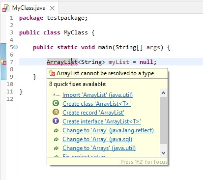

In some cases, Eclipse does not offer the expected missing import as a quick fix.
I noticed the issue with a brand new download of eclipse-jee-2023-03-R-win32-x86_64, without changing any preference/option.
To reproduce the issue:
1) Create a new "Java Project" with the default options
2) Create a new class with the following main method:
package testPackage;
public class MyClass {
		ArrayList<String> myList = null;
3) With this code, I get the option to add the expected import - see screenshot 1:
index.php/fa/43243/0/

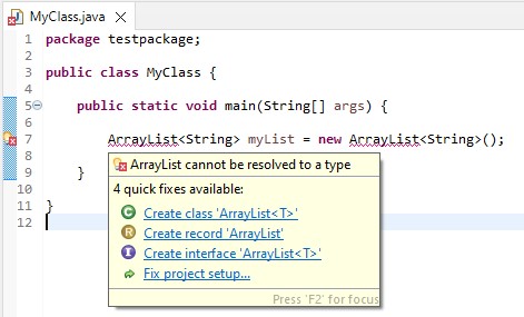

4) Change the code to:
		ArrayList<String> myList = new ArrayList<String>();
5) Now, the option to add the expected import is not there anymore - see screenshot 2
index.php/fa/43244/0/
Is it a known issue? Or a misconfiguration on my side?

  • Attachment: 1.jpg
    (Size: 43.90KB, Downloaded 2028 times)
  • Attachment: 2.jpg
    (Size: 35.78KB, Downloaded 2093 times)
