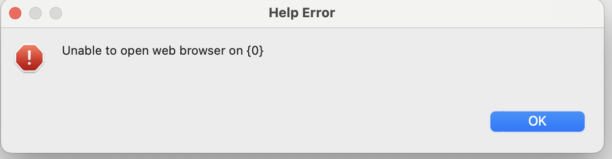

But once built and deployed to a macOS system it fails with a Help Error dialog and a message 'Unable to open web browser on {0}.
This occurs on Ventura, Big Sur and Catalina macOS systems.

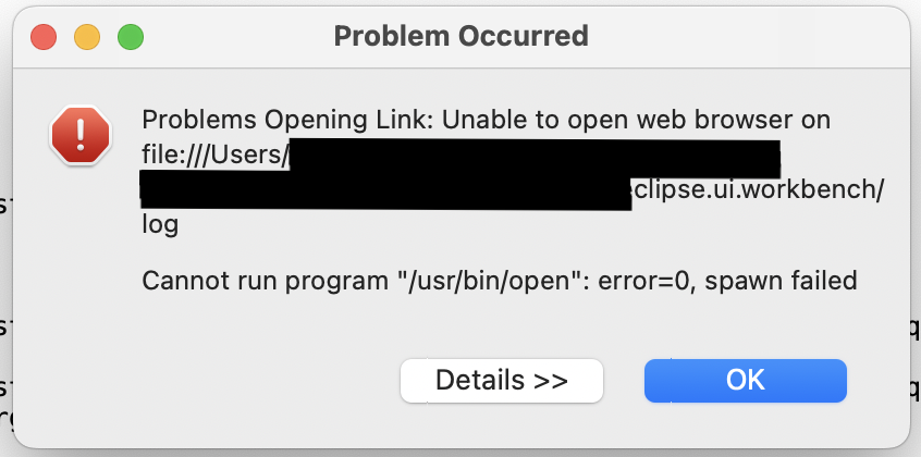

Also, I cannot view the error log as this also fails with an unable to open web browser error - see screenshot. As before viewing the error log is possible on other operating systems and from within an Eclipse product launch.
It seems to be an issue with launching scripts - see the error in the screenshot
cannot run program "usr/bin/open"; error=0, spawn failed.
I've checked and the script is there.
Perhaps this is a permissions issue? I'm not even sure where and how to start working out what the error is. There is nothing shown in the log file and I cannot debug it as it works fine in the dev environment .
