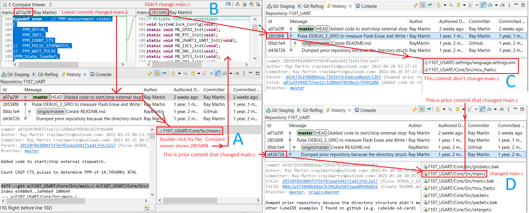

My last local commit changed main.c and the lower right of the History panel lists that file.
If I double-click main.c in that list, it opens the "C" Compare Viewer. It highlights the changes but the commit ID it references is simply the prior commit, which in this case didn't change main.c.
I suppose this is technically correct but it's also misleading. Shouldn't it by default reference the commit ID that previously changed that file rather than the ID of the prior commit?

Added image that highlights the issue. Items "A" - "D" in that image are summarized below:
A - Latest commit changed main.c. Double click that file in "changed" list.
B - Compare view shows changes from prior commit (28558f8)
C - That commit didn't change main.c
D - Prior commit that changed main.c is D436726
I have to manually click each commit to find the previous one that changed that file. Not a big deal if repo only has a few commits but it could have many more.

We actually had it the way you suggest/expect a while back. That turned out to be confusing in other contexts, though. It also comes with a non-negligible cost -- imagine a file last touched thousands of commits ago: one would have to traverse the history back until one hits that commit.
But EGit could probably choose one or the other method, depending on how exactly the comparison was triggered.
You might also want to explore "Focus on this file" in the history view, which filters the history to only show commits that touch that file. Or the "Link with Editor and Selection" button (top right in the view, two arrows pointing left and right), which does the same based on the current active editor or selection. That can be customized via the "File Scope for History" button (the funnel).
