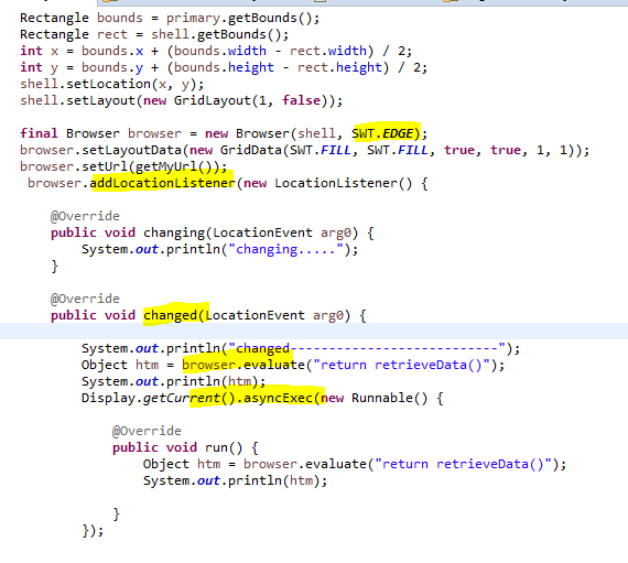

I want data return from edge browser. When i was using IE its working but in edge NOT
browser.evaluate(); every time its returning null
I have also tried with asyncExec but call is not coming inside
I have attached code snap.
Anyone having idea how to solve this please let me know
Thanks in advance..

A number of things don't work with Edge. It's browser security related. You need to implement alternatively! It's not an issue of SWT.

Can u give some pointer how we can do with edge or chrome in SWT.
Any other way ?
What I want is the data return from browser(Chrome or edge ) once we perform some action in browser by using Java .
