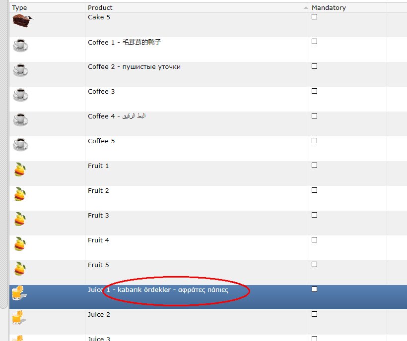

In our RAP application we have some text data that includes various national language characters. In a Table this data is rendered correctly, so no problems there:
index.php/fa/43206/0/

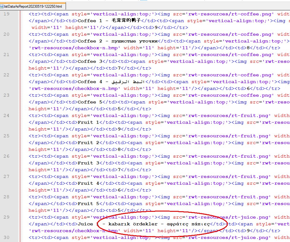

An option in our application is to produce an HTML report of this data, which we do by writing an rwt-resource - a new .html file. Viewing this html file directly with something like NotePad++ in UTF8 encoding shows the text data correctly, so we know the file is good:
index.php/fa/43207/0/

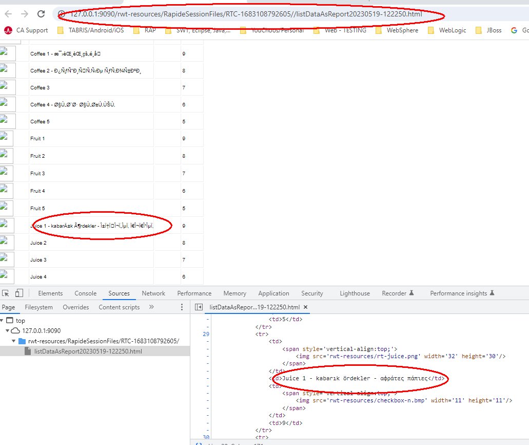

However, if we register that file as an RWT resource and open it up, the browser displays that text wrong (doesn't matter what browser type). Note the URL is rwt-resource so served by RAP:
index.php/fa/43208/0/

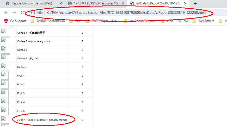

It does not appear to be a browser problem because if we navigate Explorer directly to that work directly and open the html file manually then it displays the same file correctly (see the c:\JVM URL):
index.php/fa/43209/0/
Why is the html not displaying correctly when served up through RAP as an RWT-resource, but the file is clearly ok?

Hi John,
without testing your snippet yet I found that in the generated HTML the charset definition is missing:
<meta http-equiv="content-type" content="text/html; charset=UTF-8">
Also the
FileWriter
is created without specifying the charset. Try to use
java.io.FileWriter.FileWriter(File, Charset)
Ivan
[Updated on: Tue, 30 May 2023 02:25] by Moderator
Re: UTF8 characters not displaying in html served by RAP appserver [message #1859326 is a reply to message #1859306] Wed, 31 May 2023 03:57 Go to previous messageGo to next message
Thanks Ivan, hadn't considered either aspect. I've added the charset meta tag into the html and this has resolved it.
Do you think specifying the Charset on FileWriter is necessary? Would UTF-8 not be the default anyway? The content of the file itself looked OK anyway.
Re: UTF8 characters not displaying in html served by RAP appserver [message #1859349 is a reply to message #1859210] Thu, 01 June 2023 11:01 Go to previous message
Hi John,
my experience shown that if you rely on "defaults", soon or later you will run into trouble. The default "file.encoding" property is platform (OS) specific. To be on the safe side I would suggest to set it.
Ivan
