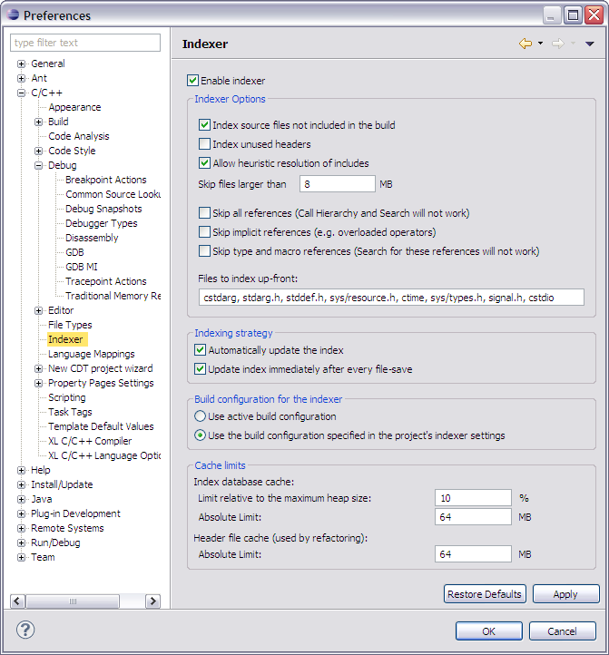

I want to update index unused headers option in indexer preference page - Programmatically in eclipse rcp. Any help is appreciated. Thanks in advance!

You can programmatically alter indexer preferences by accessing the preference store using `org.eclipse.core.runtime.preferences.InstanceScope`. Use the `getNode()` method with the argument as `"org.eclipse.cdt.core"`, which is the plugin ID for CDT Core. To change the unused headers indexing, set the `"indexerUnusedHeadersWithDefaultLang"` preference to `true` or `false` using the `putBoolean()` method. Remember to invoke `flush()` on the preference store to save changes.
