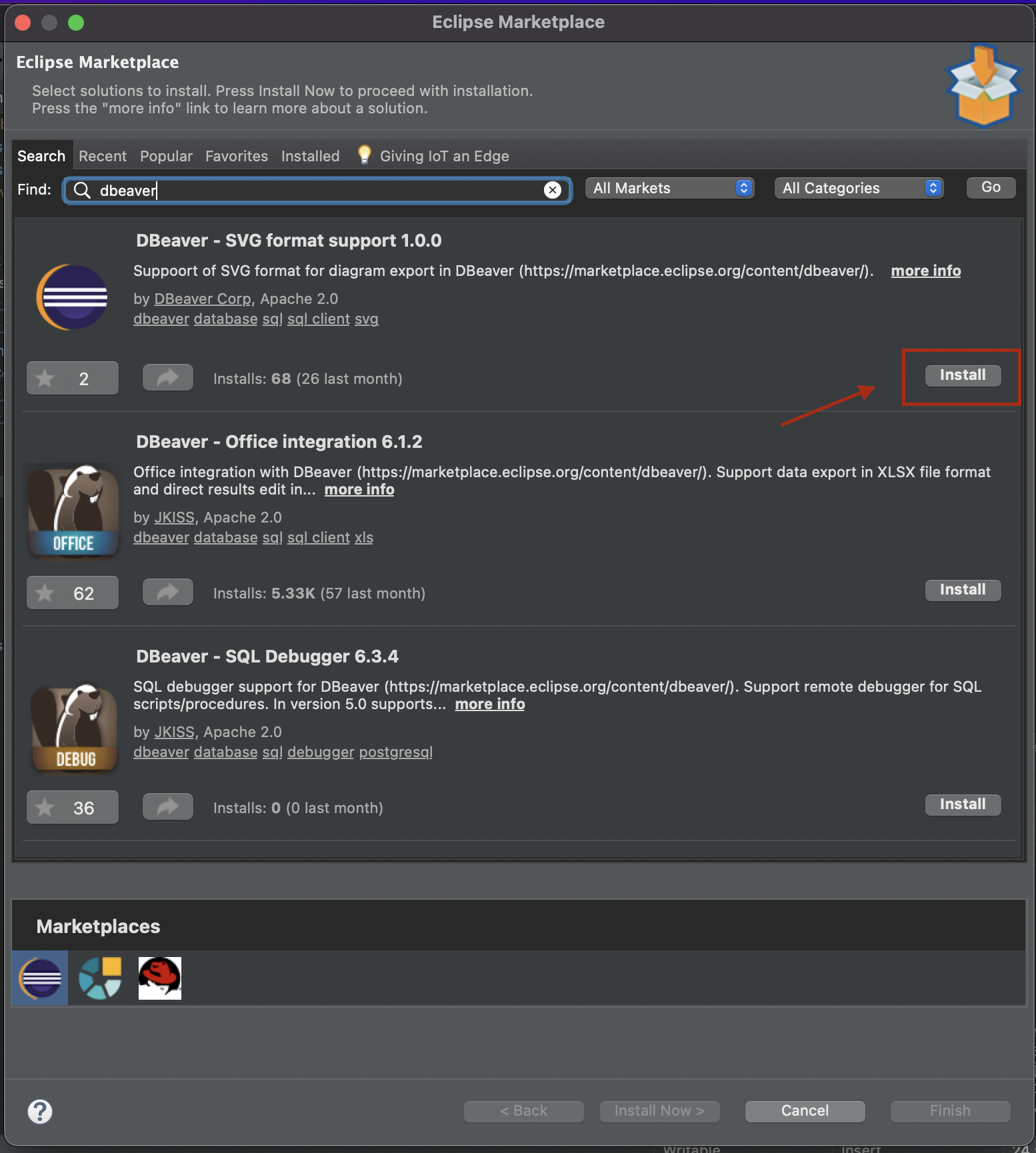

Okay, Now i'm super confused about how Eclipse Marketplace client work, please bear with me, I'm new to it and clearing these kind of doubts could help me going forward. My goal is to list my plugin under MarketPlace inside Eclipse IDE.
Follow-up question-
- What does the button "Install" in the marketplace in Eclipse button point to ? Does that point to update-site URL of latest version submitted to marketplace listing? If yes, what if we could GitHub repository link that has update-site unzipped content will that suffice or it needs to be hosted somewhere?
Your help is much appreciated.
Re: Queries regarding listing Eclipse Plugin on Marketplace Client [message #1858934 is a reply to message #1858933] Tue, 02 May 2023 08:24 Go to previous message
Maybe it helps to see the raw information in another listing:
https://marketplace.eclipse.org/content/spotbugs-eclipse-plugin/api/p
The really important information in term sof "what does install do" is this:
<updateurl>https://spotbugs.github.io/eclipse/</updateurl>
<ius>
<iu required="TRUE">com.github.spotbugs.plugin.eclipse</iu>
</ius>
This tells what URL contains the update site. You'll note this URL works in the Repository Explorer. Yours should too. The other important information is the IU (installable unit) to install. This should be the "id" of the feature(s) you want the user to installer. Again the repository explorer in advanced mode will show you such details so you can get it right. And as I said, a zipped site is not ideal.
