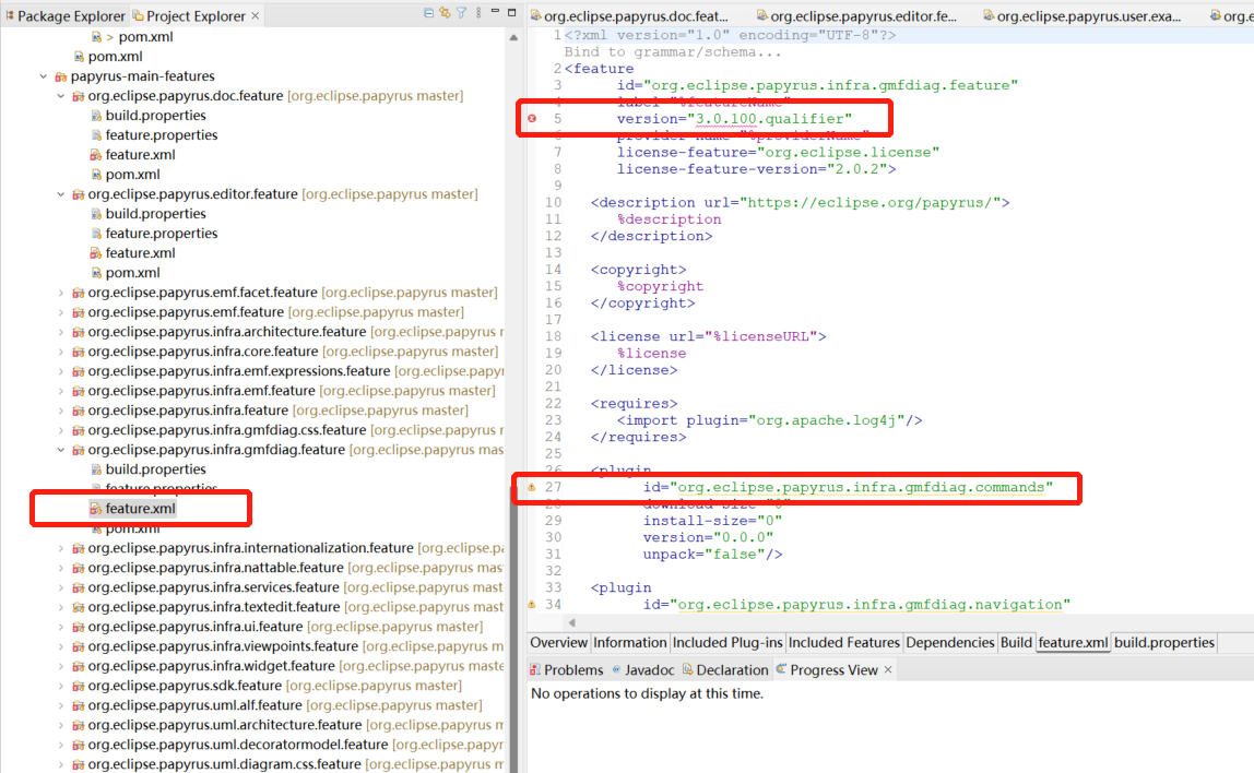

1.In many plugins under the plugins package, the Export-Package parameter in the MANIFEST.MF file under the META-INF will report an error. The package under the src does, and I haven't touched the source code yet;
2.In the features package, <feature id="" version=""> <plugin id=""/> prompts version modification problems in almost all feature.xml. Roughly content for "plug-in reference 'org. Eclipse. Papyrus. Example. Core. Lifecycleevents' has had changed from 1.2.0 the to2.0.0",But almost all version numbers in feature.xml are 0.0.0. I don't know if I can understand this description, actually I should post a picture, but the forum can't do it directly;

Re: Compile the papyrus source code [message #1858645 is a reply to message #1858562] Thu, 13 April 2023 07:54 Go to previous messageGo to next message
as the continuous build is fine, there are no issues with the source code. Since the git repository contains a consistent set of plugins with a certain version number, the feature.xml file does not duplicate this information, i.e. describes which plugins are included but not their version number.
It's typically a good idea to start with an existing binary installation of Papyrus and only import a very small subset of plugins from source code (with matching version number, i.e. corresponding git tag) instead of trying to compile "everything".

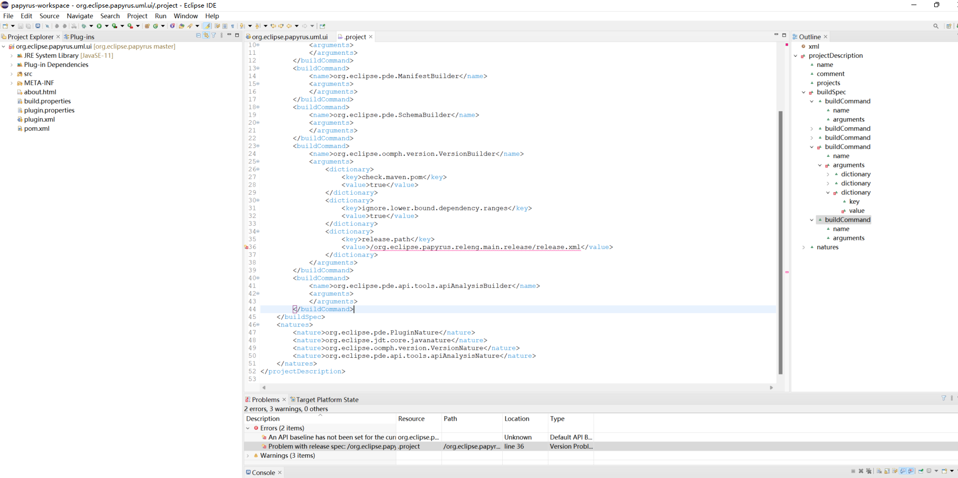

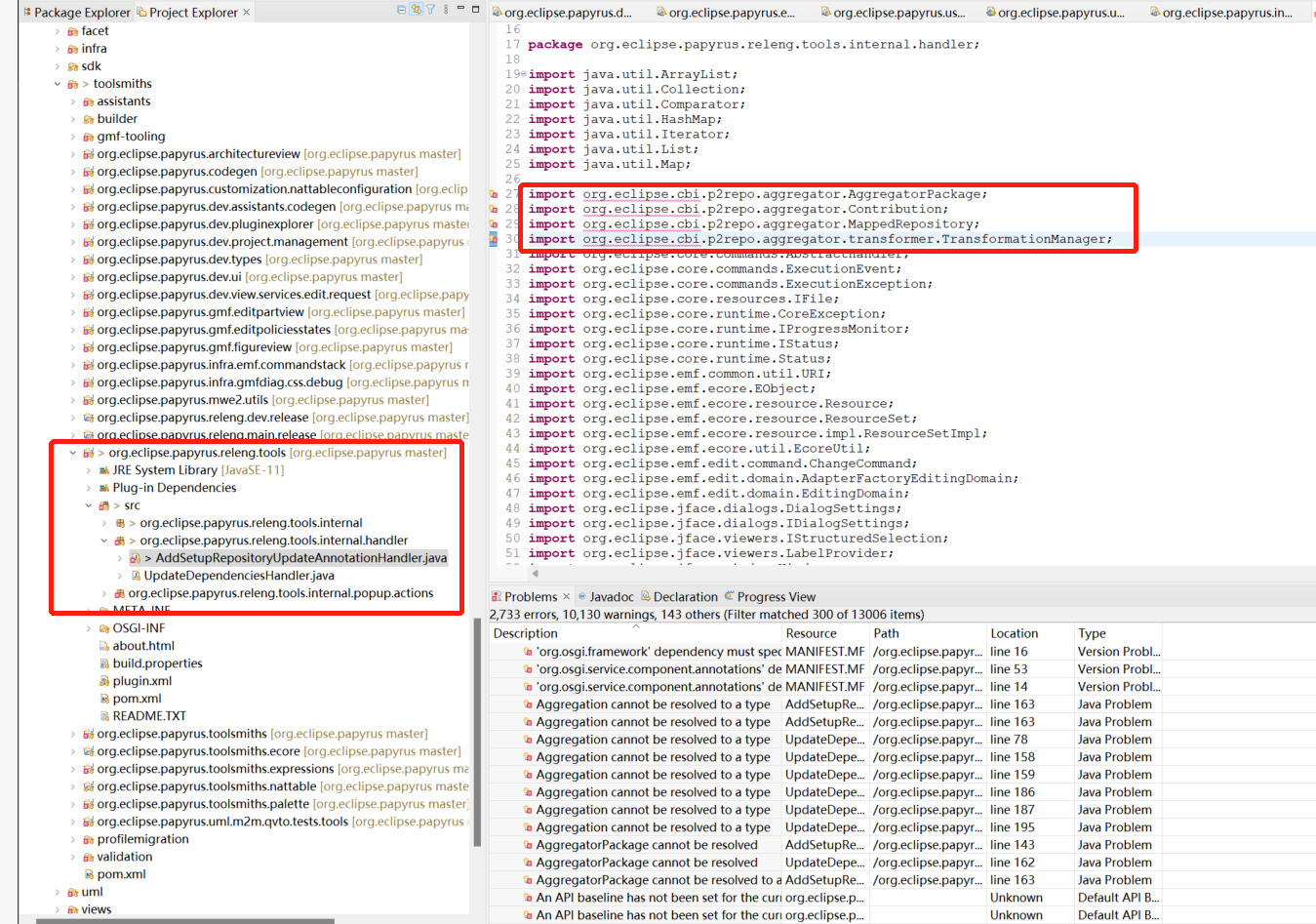

Hello Pauline,
I have a new problem,As shown in Figure 1, when compiling a single plug-in, there will be an error as shown in the figure.
I want to know what the left directory is like when compiling or developing by yourself. I don't need to know the code, but just want to see the directory structure, so that I can compile and modify correctly.
really hope you can reply and help me.

Re: Compile the papyrus source code [message #1858743 is a reply to message #1858645] Wed, 19 April 2023 01:58 Go to previous messageGo to next message
Hello Ansgar Radermacher,
I'll try to import a very small subset of plugins from source code,But it still failed to compile,As shown in Figure 1, I don't know if it's my environment.So, I'd like to ask about the environment needed to compile small subset(Hopefully the official version):
1.linux,mac or windows?
2.The version between eclipse version and papyrus version corresponds to the requirements?
3.Which version of maven uses?
In addition to the question, I would like to know the detailed steps for compiling a small subset. If this detailed step is provided,Would be greatly appreciated.
guo jie

Re: Compile the papyrus source code [message #1858772 is a reply to message #1858743] Thu, 20 April 2023 08:40 Go to previous messageGo to next message
Guo,
can you tell us why you want to compile Papyrus?
There are two options
1. compile "everything" using maven. This can be done with any OS that supports maven (via "mvn clean verify"). I personally use mvn 3.8.5. on a Ubuntu 22 machine, but I typically prefer to let the CI job on eclipse.org do that.
2. Only use a (small) subset of plugins, as you've started to do. A typical motivation is to debug a plugin or apply changes. In this case, you do that in an Eclipse that has already a matching Papyrus version installed. Eclipse compiles the code of the imported projects without using maven at all. You should install the xtend SDK in Eclipse, as some plugins rely on generated code that is not part of the git (e.g. xtend files compile into Java code). If there are errors in a .project build-spec, they might not be relevant for you such as the oomph related one in your screenshot. Make sure that there are no errors in the MANIFEST and in the Java or xtend code.
[Updated on: Thu, 20 April 2023 08:45] by Moderator

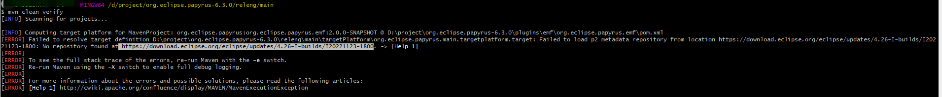

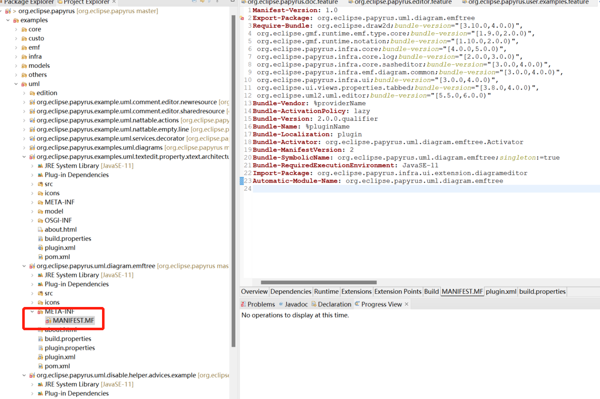

Re: Compile the papyrus source code [message #1858806 is a reply to message #1858772] Sun, 23 April 2023 22:38 Go to previous messageGo to next message
hello ,
When using "mvn clean verify" to compile, there is a dependency download failure, as shown in Figure 2. When accessing the address with the dependency, a "Not Found" error occurs, as shown in Figure 3. How to solve this situation?

Re: Compile the papyrus source code [message #1858970 is a reply to message #1858806] Wed, 03 May 2023 10:32 Go to previous messageGo to next message
it's a good idea to compile "only" main Papyrus (still 487 plugins). This can be done by launching a clean verify in the subfolder "releng/main".

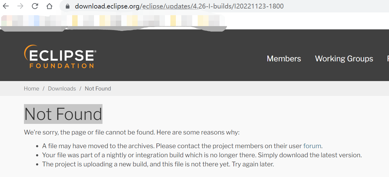

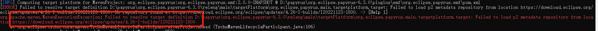

Yes, I tried to do so, but it still shows that the website https://download.eclipse.org/eclipse/updates/4.26-I-builds/I20221123-1800 does not have any content, so it will report an error at the step shown in the figure. Is it because the content in the repository has been deleted or updated, and the reason for the address not being updated in the code?

Re: Compile the papyrus source code [message #1859095 is a reply to message #1859013] Thu, 11 May 2023 08:15 Go to previous message
https://download.eclipse.org/eclipse/updates/4.26-I-builds/I20221123-1800 was an Eclipse integration build. It disappeared several weeks ago.
I suggest you to start a build from the tag 6.4.0. You can checkout it with this command :
git checkout -b local/6.4.0 6.4.0
and launch the following maven command at the root of the repository:
mvn clean verify -f releng/main/pom.xml
