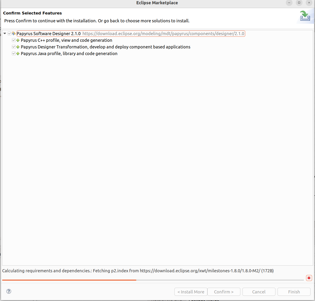

Im trying to install from Marketplace, Papyrus Designer Software Designer from 2.1.0:

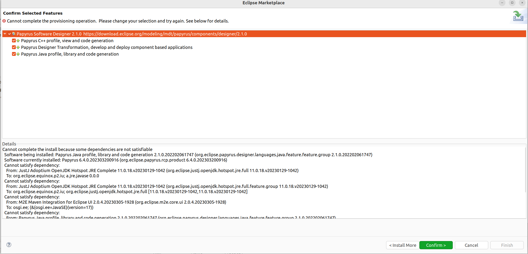

Im facing this problem: Cannot complete the provisioning operation. Please change your selection and try again. See below for details.
index.php/fa/43074/0/
index.php/fa/43075/0/
Details:
Cannot complete the install because some dependencies are not satisfiable
Software being installed: Papyrus Java profile, library and code generation 2.1.0.202202061747 (org.eclipse.papyrus.designer.languages.java.feature.feature.group 2.1.0.202202061747)
Software currently installed: Papyrus 6.4.0.202303200916 (org.eclipse.papyrus.rcp.product 6.4.0.202303200916)
Cannot satisfy dependency:
From: JustJ Adoptium OpenJDK Hotspot JRE Complete 11.0.18.v20230129-1042 (org.eclipse.justj.openjdk.hotspot.jre.full 11.0.18.v20230129-1042)
To: org.eclipse.equinox.p2.iu; a.jre.javase 0.0.0
From: JustJ Adoptium OpenJDK Hotspot JRE Complete 11.0.18.v20230129-1042 (org.eclipse.justj.openjdk.hotspot.jre.full.feature.group 11.0.18.v20230129-1042)
To: org.eclipse.equinox.p2.iu; org.eclipse.justj.openjdk.hotspot.jre.full [11.0.18.v20230129-1042,11.0.18.v20230129-1042]
From: M2E Maven Integration for Eclipse UI 2.0.4.20230305-1928 (org.eclipse.m2e.core.ui 2.0.4.20230305-1928)
To: osgi.ee; (&(osgi.ee=JavaSE)(version=17))
From: Papyrus Java profile, library and code generation 2.1.0.202202061747 (org.eclipse.papyrus.designer.languages.java.feature.feature.group 2.1.0.202202061747)
To: org.eclipse.equinox.p2.iu; org.eclipse.papyrus.designer.languages.java.jdt.project [2.1.0.202202061747,2.1.0.202202061747]
From: Papyrus Designer JDT support 2.1.0.202202061747 (org.eclipse.papyrus.designer.languages.java.jdt.project 2.1.0.202202061747)
To: osgi.bundle; org.eclipse.m2e.core.ui 1.7.0
From: Papyrus 6.4.0.202303200916 (org.eclipse.papyrus.rcp.product 6.4.0.202303200916)
To: org.eclipse.equinox.p2.iu; org.eclipse.justj.openjdk.hotspot.jre.full.feature.group [11.0.18.v20230129-1042,11.0.18.v20230129-1042]

Re: Help generating java code in Papyrus. [message #1858400 is a reply to message #1858393] Fri, 31 March 2023 13:52 Go to previous messageGo to next message
Apparently, the issue is related to your JVM. When SW Designer is installed, it also tries to install the C++ development tools (CDT), even if you only install the Java feature. As the current version of CDT needs Java-17, this fails if your Eclipse only ships with a Java-11 JVM.
There are two options: either install a newer JVM or use the nightly update site of Designer. Some dependencies have been cleaned up since the release and it does not require CDT, if you only define Java features.

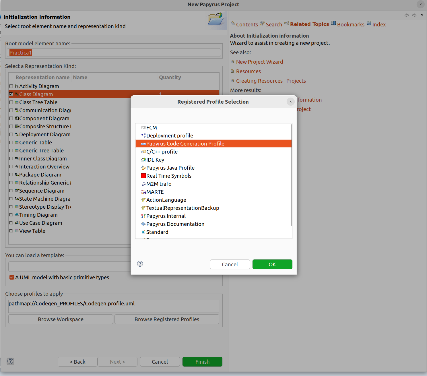

4 - Then I created a new papyrus project, so i dont know which profile to add Java Code Profile or Papyrus Code Generation, as i guess i can only insert or add one profile.

My questions are:
1 - What profile to add to the project: the Papyrus code generation Profile or Papyrus Java profile ( or c++ Profile if i need it).. or more than one profile...To be honest i dont understand what a profile registered/profile mean... You can watch screenshots in previous post to make it clearer.

Re: Help generating java code in Papyrus. [message #1858532 is a reply to message #1858529] Thu, 06 April 2023 05:45 Go to previous messageGo to next message
The profiles to add depend on what you want to do. You sometimes need a stereotype to refine the code generation. For instance, the Java code generation for an UML operation will not add the synchronized keyword, unless you apply the stereotype <<Synchronized>> from the Java profile. If you want to add a constructor or destructor, you need to apply the standard profile.
The common profile chiefly stores the generator to use. If it is not applied, the code generation dialog automatically applies it in order to save the information about the used generator - in most cases, you don't need to bother with it. It is also used for some programming language independent mechanisms such as template bindings.
You will not have a Designer 2.1.0 with Papyrus 6.5.0/Java 17, but you have a nightly SW designer 3.0.0 build offering Eclipse 2023-03 + Papyrus 6.4.0. Update-site and RCPs are available from continuous integration. It is also quite likely that I will release 3.0.0 in the next days.

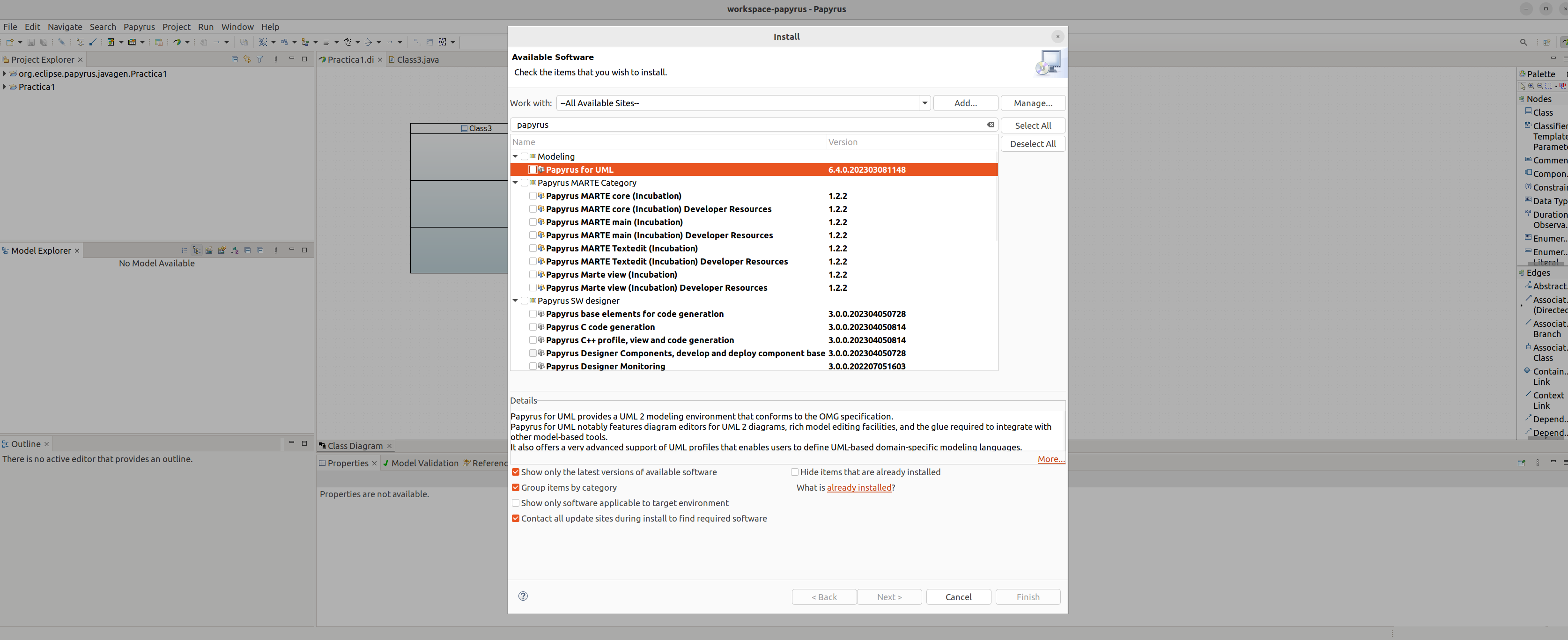

About 2: Seems that nightly build has papyrus 6.4.0 and sofware designer 3.0 as this screenshot shows:
