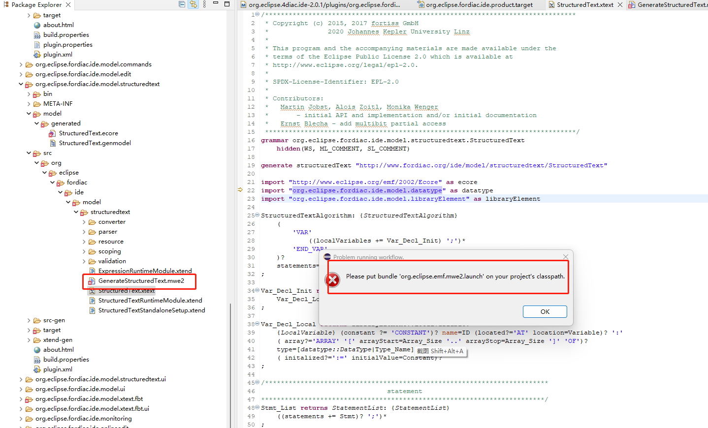

In GenerateStucturedText.mwe2, get the error "Couldn't resolve reference to JvmType 'Workflow'."
when i right click at StructuredText.xtext, then "run as"->"Generate Xtext Artifacts", got the error as the image in the attachment:
can you help me? thx

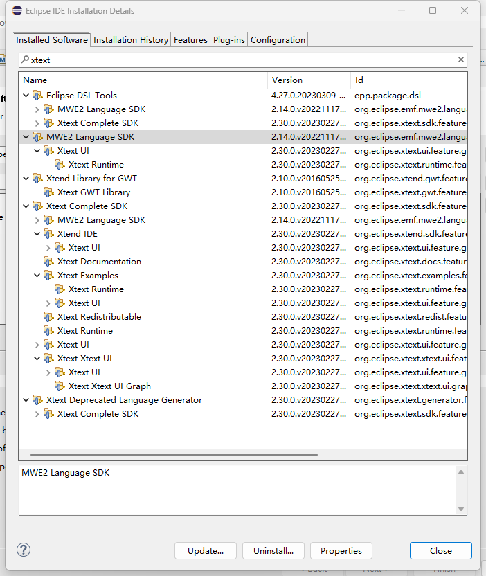

May I ask why you need this? 4diac IDE comes already with everything generated. So you could also take that code.
But if you want to experiment with it you need to ensure that in your Eclipse instance the full MWE2 Language SDK is installed. It should come with the Xtext complete SDK package, which is not per default part of the Eclipse Modelling edition anymore.

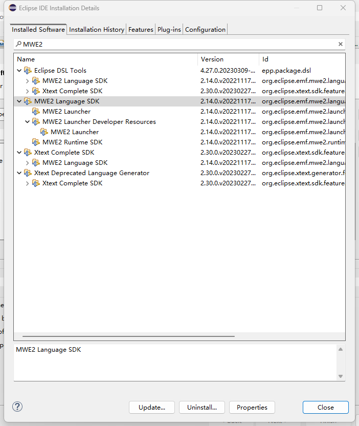

Re: how can i generate xtext artifacts [message #1858225 is a reply to message #1858211] Thu, 23 March 2023 11:23 Go to previous messageGo to next message
I have a mild obsessive-compulsive disorder. when i see the red errors , i always want to get rid of them.
In fact, i has installed those sdks, they are shown in the attachments.
