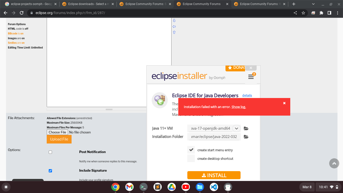

Getting error while installing IDE for Java Developers [message #1857966] Wed, 08 March 2023 12:12 Go to next message
[2023-03-08 22:41:33] Executing bootstrap tasks
[2023-03-08 22:41:33] OpenJDK Runtime Environment 17.0.2+8
[2023-03-08 22:41:33] Product org.eclipse.products.epp.package.java.2022-03
[2023-03-08 22:41:33] Bundle org.eclipse.oomph.setup 1.23.0.v20220301-0958, build=5396, branch=0ca218831ae58471d57f6865eb1ac482255de190
[2023-03-08 22:41:33] Bundle org.eclipse.oomph.setup.core 1.23.0.v20220301-0958, build=5396, branch=0ca218831ae58471d57f6865eb1ac482255de190
[2023-03-08 22:41:33] Bundle org.eclipse.oomph.setup.p2 1.18.0.v20220301-0958, build=5396, branch=0ca218831ae58471d57f6865eb1ac482255de190
[2023-03-08 22:41:33] Performing P2 Director (Eclipse IDE for Java Developers (2022-03))
[2023-03-08 22:41:33] Offline = false
[2023-03-08 22:41:33] Mirrors = true
[2023-03-08 22:41:33] Resolving 17 requirements from 3 repositoriesto /home/connect2soundaryasasikumar/eclipse/java-2022-032/eclipse
[2023-03-08 22:41:33] Requirement org.eclipse.equinox.p2.iu:epp.package.java [4.23.0,5.0.0) (filter=(|(&(osgi.arch=aarch64)(osgi.os=linux)(osgi.ws=gtk))(&(osgi.arch=aarch64)(osgi.os=macosx)(osgi.ws=cocoa))(&(osgi.arch=x86_64)(osgi.os=linux)(osgi.ws=gtk))(&(osgi.arch=x86_64)(osgi.os=macosx)(osgi.ws=cocoa))(&(osgi.arch=x86_64)(osgi.os=win32)(osgi.ws=win32))))
[2023-03-08 22:41:33] Requirement org.eclipse.equinox.p2.iu:org.eclipse.platform.feature.group [4.23.0,5.0.0)
[2023-03-08 22:41:33] Requirement org.eclipse.equinox.p2.iu:org.eclipse.rcp.feature.group [4.23.0,5.0.0)
[2023-03-08 22:41:33] Requirement org.eclipse.equinox.p2.iu:org.eclipse.buildship.feature.group
[2023-03-08 22:41:33] Requirement org.eclipse.equinox.p2.iu:org.eclipse.eclemma.feature.feature.group
[2023-03-08 22:41:33] Requirement org.eclipse.equinox.p2.iu:org.eclipse.egit.feature.group
[2023-03-08 22:41:33] Requirement org.eclipse.equinox.p2.iu:org.eclipse.epp.mpc.feature.group
[2023-03-08 22:41:33] Requirement org.eclipse.equinox.p2.iu:org.eclipse.jdt.feature.group
[2023-03-08 22:41:33] Requirement org.eclipse.equinox.p2.iu:org.eclipse.jgit.feature.group
[2023-03-08 22:41:33] Requirement org.eclipse.equinox.p2.iu:org.eclipse.m2e.feature.feature.group
[2023-03-08 22:41:33] Requirement org.eclipse.equinox.p2.iu:org.eclipse.m2e.lemminx.feature.feature.group
[2023-03-08 22:41:33] Requirement org.eclipse.equinox.p2.iu:org.eclipse.m2e.logback.feature.feature.group
[2023-03-08 22:41:33] Requirement org.eclipse.equinox.p2.iu:org.eclipse.mylyn.wikitext.editors_feature.feature.group
[2023-03-08 22:41:33] Requirement org.eclipse.equinox.p2.iu:org.eclipse.tips.feature.feature.group
[2023-03-08 22:41:33] Requirement org.eclipse.equinox.p2.iu:org.eclipse.tm.terminal.feature.feature.group
[2023-03-08 22:41:33] Requirement org.eclipse.equinox.p2.iu:org.eclipse.wildwebdeveloper.xml.feature.feature.group
[2023-03-08 22:41:33] Requirement org.eclipse.equinox.p2.iu:org.eclipse.oomph.setup.feature.group
[2023-03-08 22:41:33] Repository https://download.eclipse.org/technology/epp/packages/2022-03/202203101200
[2023-03-08 22:41:33] Repository https://download.eclipse.org/releases/2022-03/202203161000
[2023-03-08 22:41:33] Repository https://download.eclipse.org/oomph/updates/milestone/latest
[2023-03-08 22:41:39] Calculating requirements and dependencies.
[2023-03-08 22:41:41] Computing prerequisite plan
[2023-03-08 22:41:48] Collecting 1 artifacts from https://download.eclipse.org/technology/epp/packages/2022-03/202203101200
[2023-03-08 22:41:48] Downloading epp.package.java.executable.gtk.linux.x86_64
[2023-03-08 22:41:48] Collected 1 artifacts for https://download.eclipse.org/technology/epp/packages/2022-03/202203101200 in 0.021s
[2023-03-08 22:41:48] Collecting 3 artifacts from https://download.eclipse.org/releases/2022-03/202203161000
[2023-03-08 22:41:49] Downloading org.eclipse.platform_root
[2023-03-08 22:41:49] Downloading org.eclipse.rcp_root
[2023-03-08 22:41:49] Downloading org.eclipse.platform.ide.executable.gtk.linux.x86_64
[2023-03-08 22:41:49] Collected 3 artifacts for https://download.eclipse.org/releases/2022-03/202203161000 in 1.232s
[2023-03-08 22:41:49] An error was detected while performing the engine operation and the changes are being rolled back. See the log for details.
[2023-03-08 22:41:50] ERROR: org.eclipse.equinox.p2.engine code=4 An error occurred during the org.eclipse.equinox.internal.p2.engine.phases.CheckTrust phase.
at org.eclipse.oomph.util.OomphPlugin.coreException(OomphPlugin.java:295)
at org.eclipse.oomph.p2.internal.core.ProfileTransactionImpl$3.commit(ProfileTransactionImpl.java:558)
at org.eclipse.oomph.p2.internal.core.ProfileTransactionImpl.commit(ProfileTransactionImpl.java:344)
at org.eclipse.oomph.setup.p2.impl.P2TaskImpl.perform(P2TaskImpl.java:904)
at org.eclipse.oomph.setup.internal.core.SetupTaskPerformer.doPerformNeededSetupTasks(SetupTaskPerformer.java:3864)
at org.eclipse.oomph.setup.internal.core.SetupTaskPerformer.performNeededSetupTasks(SetupTaskPerformer.java:3792)
at org.eclipse.oomph.setup.internal.core.SetupTaskPerformer.performTriggeredSetupTasks(SetupTaskPerformer.java:3773)
at org.eclipse.oomph.setup.internal.core.SetupTaskPerformer.perform(SetupTaskPerformer.java:3651)
at org.eclipse.oomph.setup.internal.installer.SimpleVariablePage.installPerform(SimpleVariablePage.java:1353)
at org.eclipse.oomph.setup.internal.installer.SimpleVariablePage$20.run(SimpleVariablePage.java:1165)
ERROR: org.eclipse.equinox.p2.engine code=0 session context was:(profile=_home_connect2soundaryasasikumar_eclipse_java-2022-032_eclipse, phase=org.eclipse.equinox.internal.p2.engine.phases.CheckTrust, operand=, action=).
ERROR: org.eclipse.equinox.p2.engine code=0 Error reading signed content.
java.io.FileNotFoundException: /home/connect2soundaryasasikumar/.p2/pool/plugins/org.eclipse.m2e.logback.appender_1.17.2.20211002-0721.jar (No such file or directory)
at java.base/java.io.FileInputStream.open0(Native Method)
at java.base/java.io.FileInputStream.open(Unknown Source)
at java.base/java.io.FileInputStream.<init>(Unknown Source)
at org.eclipse.osgi.internal.signedcontent.SignedContentFromBundleFile.lambda$2(SignedContentFromBundleFile.java:197)
at org.eclipse.osgi.internal.signedcontent.SignedContentFromBundleFile.getSignedEntries(SignedContentFromBundleFile.java:222)
at org.eclipse.osgi.internal.signedcontent.SignedContentFromBundleFile.<init>(SignedContentFromBundleFile.java:192)
at org.eclipse.osgi.internal.signedcontent.SignedBundleHook.getSignedContent(SignedBundleHook.java:170)
at org.eclipse.equinox.internal.p2.engine.phases.CertificateChecker.checkCertificates(CertificateChecker.java:162)
at org.eclipse.equinox.internal.p2.engine.phases.CertificateChecker.start(CertificateChecker.java:116)
at org.eclipse.equinox.internal.p2.engine.phases.CheckTrust.completePhase(CheckTrust.java:64)
at org.eclipse.equinox.internal.p2.engine.Phase.postPerform(Phase.java:254)
at org.eclipse.equinox.internal.p2.engine.Phase.perform(Phase.java:105)
at org.eclipse.equinox.internal.p2.engine.PhaseSet.perform(PhaseSet.java:50)
at org.eclipse.equinox.internal.p2.engine.Engine.perform(Engine.java:80)
at org.eclipse.equinox.internal.p2.engine.Engine.perform(Engine.java:48)
at org.eclipse.equinox.internal.provisional.p2.director.PlanExecutionHelper.executePlan(PlanExecutionHelper.java:48)
at org.eclipse.oomph.p2.internal.core.ProfileTransactionImpl$3.commit(ProfileTransactionImpl.java:554)
