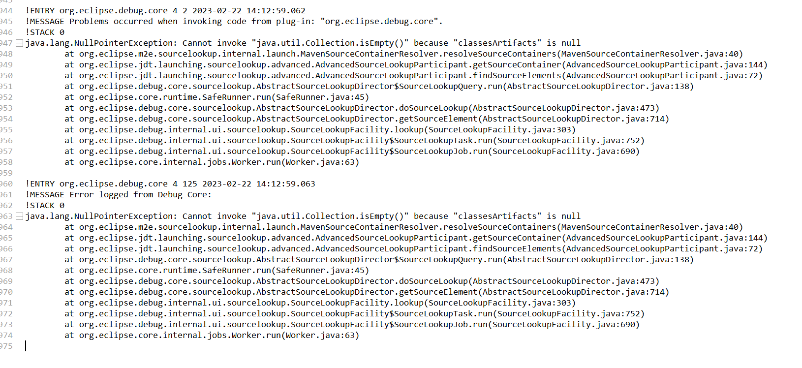

I fallback to Version: 2022-06 (4.24.0) Build id: 20220609-1112 . It 's doing well ! below is relevant lookings , I hope that can help you ,THX!
!ENTRY org.eclipse.debug.core 4 125 2023-02-22 14:12:59.063
!MESSAGE Error logged from Debug Core:
!STACK 0
java.lang.NullPointerException: Cannot invoke "java.util.Collection.isEmpty()" because "classesArtifacts" is null
	at org.eclipse.m2e.sourcelookup.internal.launch.MavenSourceContainerResolver.resolveSourceContainers(MavenSourceContainerResolver.java:40)
	at org.eclipse.jdt.launching.sourcelookup.advanced.AdvancedSourceLookupParticipant.getSourceContainer(AdvancedSourceLookupParticipant.java:144)
	at org.eclipse.jdt.launching.sourcelookup.advanced.AdvancedSourceLookupParticipant.findSourceElements(AdvancedSourceLookupParticipant.java:72)
	at org.eclipse.debug.core.sourcelookup.AbstractSourceLookupDirector$SourceLookupQuery.run(AbstractSourceLookupDirector.java:138)
	at org.eclipse.core.runtime.SafeRunner.run(SafeRunner.java:45)
	at org.eclipse.debug.core.sourcelookup.AbstractSourceLookupDirector.doSourceLookup(AbstractSourceLookupDirector.java:473)
	at org.eclipse.debug.core.sourcelookup.AbstractSourceLookupDirector.getSourceElement(AbstractSourceLookupDirector.java:714)
	at org.eclipse.debug.internal.ui.sourcelookup.SourceLookupFacility.lookup(SourceLookupFacility.java:303)
	at org.eclipse.debug.internal.ui.sourcelookup.SourceLookupFacility$SourceLookupTask.run(SourceLookupFacility.java:752)
	at org.eclipse.debug.internal.ui.sourcelookup.SourceLookupFacility$SourceLookupJob.run(SourceLookupFacility.java:690)
	at org.eclipse.core.internal.jobs.Worker.run(Worker.java:63)
!ENTRY org.eclipse.debug.core 4 2 2023-02-22 14:12:59.062
!MESSAGE Problems occurred when invoking code from plug-in: "org.eclipse.debug.core".
!STACK 0

Thanks! Looks this warrants a bug. At this point, I am not sure whether this belongs in JDT or M2E, but since the exception has root in M2E, we can start with a bug there:
https://github.com/eclipse-m2e/m2e-core/issues
