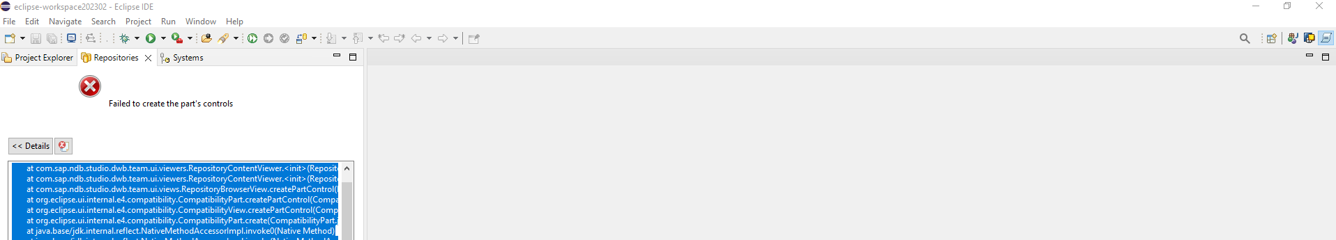

Repository error in HANA Development Tools [message #1857665] Mon, 20 February 2023 10:42 Go to next message
In the HANA development tools perspective of eclipse, when clicking Repositories, I get this error log:
Can you identify what is wrong/what I can do in order to fix it?
I am connected to my Systems and Project just fine.

Re: Repository error in HANA Development Tools [message #1857666 is a reply to message #1857665] Mon, 20 February 2023 11:11 Go to previous messageGo to next message
Eclipse.org does not provide the HANA Development Tools or a perspective for them, but it looks like they are not compatible with
the release of Eclipse you are using. Contact their support.
Re: Repository error in HANA Development Tools [message #1857670 is a reply to message #1857666] Mon, 20 February 2023 14:54 Go to previous message
that answer actually gave me the clue - version incompatibility. Thanks!
