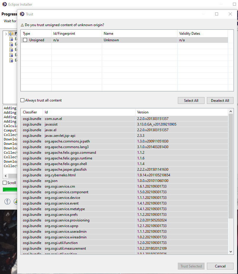

When installing cdt with the latest Ooumph I get strange warnings for unsigned plugins when installing. I would expect that things from org.osgi* are signed properly but I still get the warnings.
Moreover, trying to install the plugins that are signed by our company gives the same type of warnings. However, downloading a packaged version of Eclipse CDT directly does not give the same warnings.
Any ideas on what might be going on here?
Re: Untrusted content when installing cdt [message #1857474 is a reply to message #1857472] Thu, 09 February 2023 08:11 Go to previous message
It's like I explained here:
https://www.eclipse.org/forums/index.php/mv/msg/1112450/1857399/#msg_1857399
Some things are unsigned because they are really old and the root certificate is not in the cacerts anymore. Some are unsigned with recent Java 11 and 17 versions where sha1 signatures are treated as unsigned. Is an annoying mess. Most of this content has now been pgp signed, but if you have them in your bundle pool already, the PGP signature won't be there. I'm thinking maybe I have to implement something that will copy the PGP signatures into the bundle pool's artifacts.xml so that 1000 people don't complain. :-(
