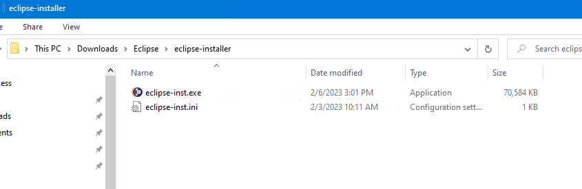

I am using a self hosted EclipseProductCatalog for many years now and had packaged up an eclipse installer for my teams to download and run. However recently the installer broke and I am attempting to update the code base of the installer with the latest version. However when I download the latest self extracting installer that only contains a ".exe" file, I can't seem to figure out to to redirect it on first run to point to my product catalog. In the old version I had an ".ini" file with the same name as the installer (eclipse-inst.ini) and placed it in the directory with the eclipse-inst.exe and added the product catalog redirect.
The new installer isn't reading the .ini file at all and it is not redirecting to the product catalog. How can I fix this?
