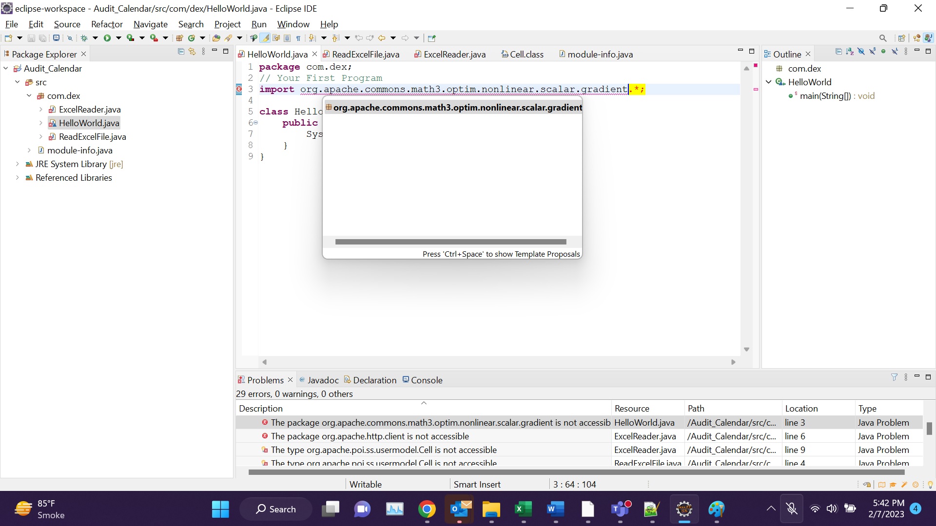

I have recently installed Eclipse IDE 2022-12 on my laptop (Version: 2022-12 (4.26.0) Build id: 20221201-1913)

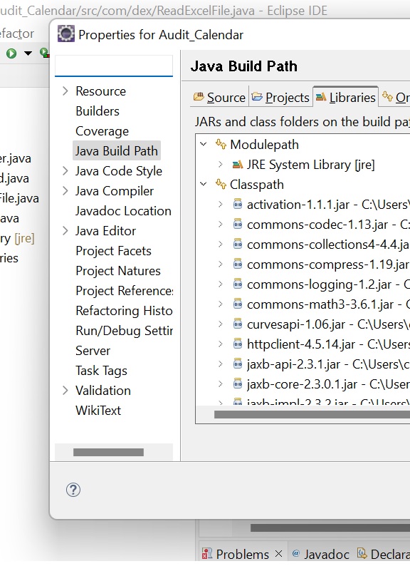

I am trying to run basic java program to load excel file using org.apache.poi libraries. However, eclipse is unable to access the imported library classes (org.apache.poi.xssf.usermodel.XSSFColor) even though the related jar files were added to classpath (java build path->libraries).
Tried with another jar httpclient jar file and noted same behavior, eclipse unable to access class file (org.apache.commons.math3.optim.nonlinear.scalar.gradient.*)
For httpclient ctrl+space shows the org.apache.commons.math3.optim.nonlinear.scalar.gradient class but still getting not accessible error. Any suggestion what could be wrong? (related screenshot attached)

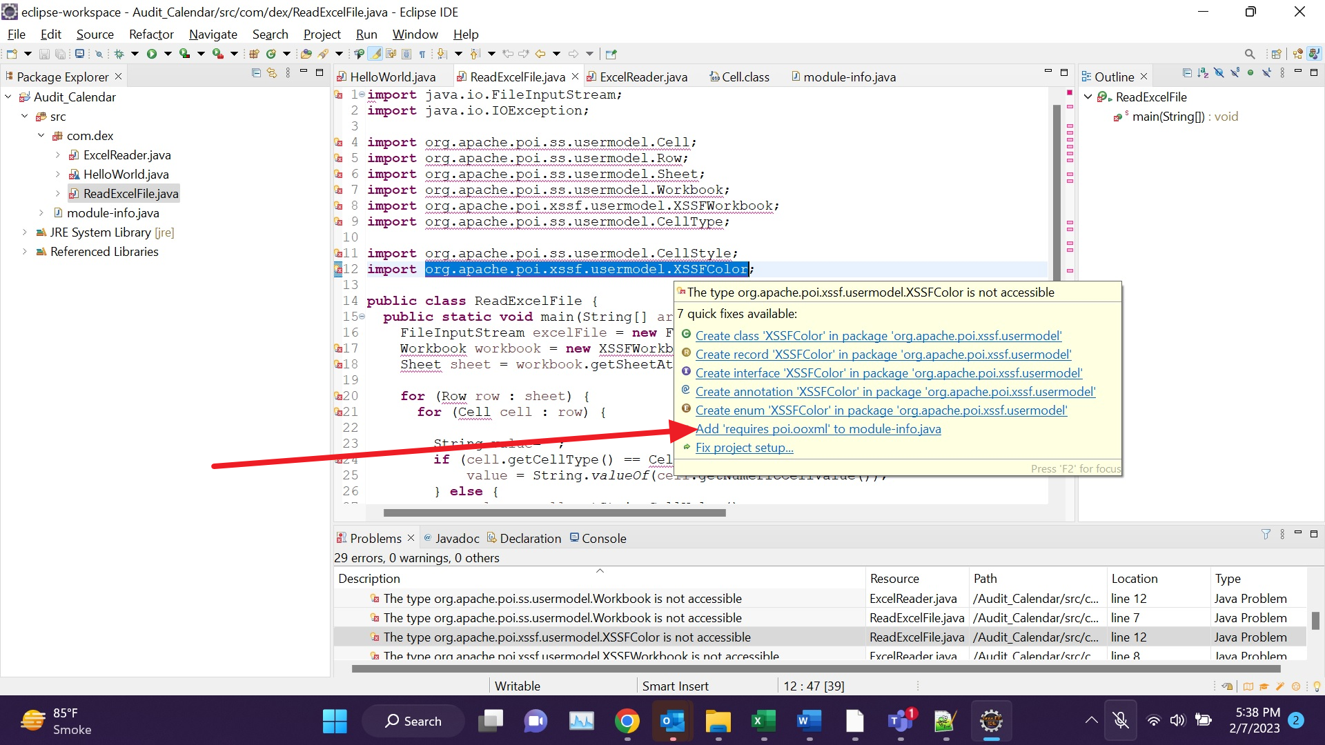

Hi there,
You use module-info.java.
So you have to add the required modules names to it.
Actually, If you look, eclipse is telling you so right here:
index.php/fa/42898/0/
Regards.
Re: Unable to use external jar files with Eclipse 2022-12 [message #1857453 is a reply to message #1857443] Wed, 08 February 2023 08:35 Go to previous messageGo to next message
Hi again,
If you do not plan to create a module, you can also delete module-info.java.
Re: Unable to use external jar files with Eclipse 2022-12 [message #1857481 is a reply to message #1857453] Thu, 09 February 2023 12:52 Go to previous messageGo to next message
Hi Eitan,
Thank you so much for the guidance here. I am using eclipse after gap of few years. The module-info Java file was auto created when I created a new project. I believe this was not case when I worked on some older versions of eclipse. I did note this file but was not aware of its functionality or if it could cause the import issue. Thank you for pointing it out and saving me lot of time and energy.
I deleted module-info java file and the import issues got resolved automatically.
Thanks & Regards,
Chintan

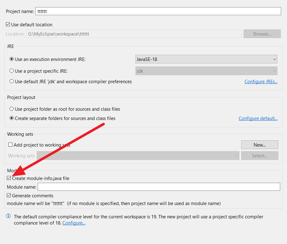

I just checked, and the creation of module-info.java is checked by default:
index.php/fa/42903/0/
