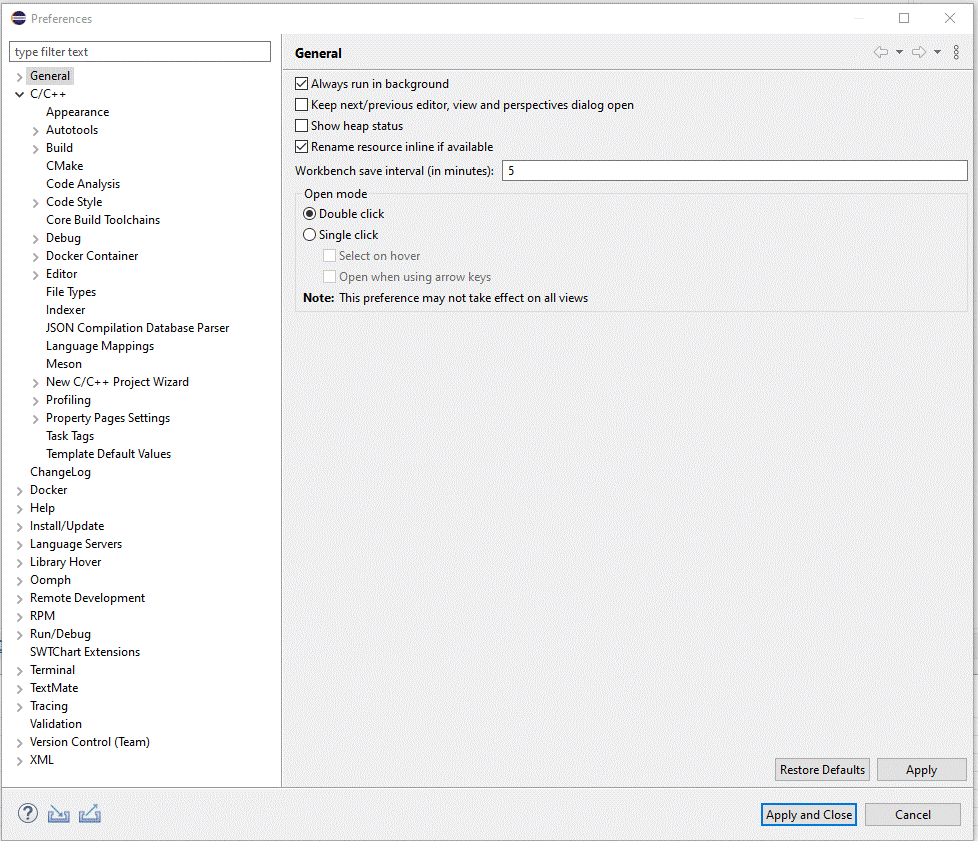

Now that it is installed, I am unable to even get started because there is no way to start an Arduino project.
I tried restarting my computer and that made no difference.

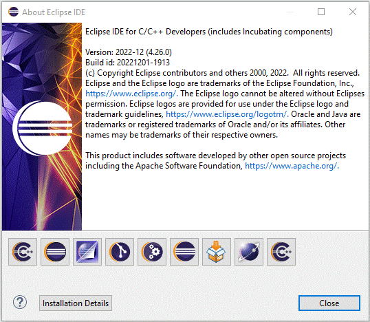

I have included a picture showing my Preferences, and one of my version information.

Installing the C/C++ support is a good start, but you should check the full video description to see if that's all you needed--I would think not.
You probably also need Sloeber from http://eclipse.baeyens.it/, as the C/C++ tools default to thinking you're targeting a system like
what they're being run on.
