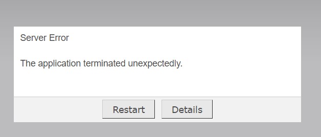

We get DataSource from Tomcat for RAP applications use in either Activator.java or Application.java.
Context cxt = new InitialContext()
has no problem under environment below,
RAP 3.5
JDK 8u77
Tomcat 9.0.69
We tried to migrate to the followings but faild
RAP 3.17
openjdk-11.0.2 / jdk-11.0.16.1
Tomcat 9.0.69
According to the message box, problems occured on 'Context cxt = new InitialContext()'.
And we are sure the JNDI is OK due to 'Context cxt = new InitialContext()' in our another web service API works well without this problem.
the error message:
HTTP Status 500 Internal Server Error
Type Exception Report
Message Exception while executing application myRAPApp.Application
Description The server encountered an unexpected condition that prevented it from fulfilling the request.
Exception
java.lang.RuntimeException: Exception while executing application myRAPApp.Application
org.eclipse.rap.ui.internal.application.EntryPointApplicationWrapper.createUI(EntryPointApplicationWrapper.java:44)
org.eclipse.rap.rwt.internal.lifecycle.RWTLifeCycle.createUI(RWTLifeCycle.java:177)
org.eclipse.rap.rwt.internal.lifecycle.RWTLifeCycle$UIThreadController.run(RWTLifeCycle.java:290)
java.base/java.lang.Thread.run(Thread.java:834)
org.eclipse.rap.rwt.internal.lifecycle.UIThread.run(UIThread.java:107)
Root Cause
javax.naming.NoInitialContextException: Cannot instantiate class: org.apache.naming.java.javaURLContextFactory [Root exception is java.lang.ClassNotFoundException: org.apache.naming.java.javaURLContextFactory]
java.naming/javax.naming.spi.NamingManager.getInitialContext(NamingManager.java:719)
java.naming/javax.naming.InitialContext.getDefaultInitCtx(InitialContext.java:305)
java.naming/javax.naming.InitialContext.init(InitialContext.java:236)
java.naming/javax.naming.InitialContext.<init>(InitialContext.java:184)
myRAPApp.Application.start(Application.java:139)
org.eclipse.rap.ui.internal.application.EntryPointApplicationWrapper.createUI(EntryPointApplicationWrapper.java:38)
myRAPApp.Application.start(Application.java:139) points to
Context cxt = new InitialContext();
We tried over and over agian, still can not figure out and find the solution.
Please help!
Thank you!
Best Regards,
David
