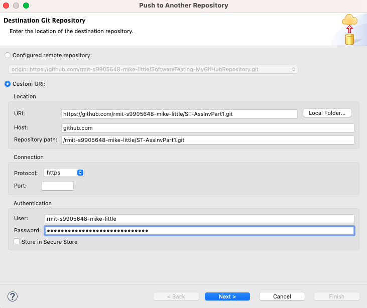

I am trying to upload/push a local repository to my GitHub at:
https://github.com/rmit-s9905648-mike-little/ST-AssInvPart1.git
By choosing from the context menu of the repository I wish to push from the Package Explorer, Team>Remote> Push
And the Push to Another Repository dialog appears and I populate it accordingly to the attached screen shot..
When I press next Eclipse prompts for the username and password that I had previously supplied and after three attempts it logs me out with the following Error Message:
Transport Error: Cannot get remote repository refs.
https://github.com/rmit-s9905648-mike-little/ST-AssInvPart1.git: not authorized

I recently updated my version of Eclipse to the latest build, but as you can see from the screen shot "Push to Another Repository", the Authentication form only prompts for Username and Password, how do I get it to prompt for a personal Auth token for remote connections? Is there a configuration setting?
