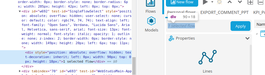

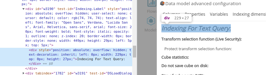

we are facing a little issue when label text font is set to italic.
The div element wrapping the text node, inside the label's node, has got a calculated width for normal font.
But it doesn't change when text is set to italic, and the end is a bit truncated, which is imperfect :
index.php/fa/42762/0/
index.php/fa/42763/0/
Setting a mutation observer https://developer.mozilla.org/en-US/docs/Web/API/MutationObserver on client label's node might be a solution, in order to update div's width according to real text width (https://stackoverflow.com/questions/118241/calculate-text-width-with-javascript)
