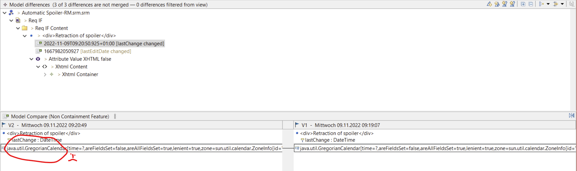

I'm trying to compare versions of a ReqIF model which apparently contains attributes of type GregorianCalendar. In the upper editor area these values are displayed correctly but in the lower area (TableContentMergeViewer) it appears that just toString() is called. And that results in different/poor text representations. Please see the attached screenshot.
What can I do to fix this?

Perhaps some more background from debugging:
The constructor of org.eclipse.emf.compare.ide.ui.internal.contentmergeviewer.table.TableContentMergeViewer creates a ComposedAdapterFactory, which is then used in the label provider's getColumnText() method, more exactly its super method AdapterFactoryLabelProvider.getColumnText(Object, int). But that method can only deal with EObjects, so that it falls back to GregorianCalendar.toString().

I believe the best shot EMF Compare has at displaying a proper label is the AdapterFactory as we are using it... The StructureMergeViewer should also be using that, is the same ItemProvider used in both viewer (the SMV at the top and Table viewer in the bottom viewers)? If so, why would the top show the correct representation but no bottom one?

I think the problem is that the MergeViewerItem has java.util.GregorianCalendar instances in both fLeft and fRight fields. In super.getColumnText() it attempts adapterFactory.adapt(object, ITableItemLabelProviderClass), but the object is a GregorianCalendar and not an EObject. So it'll always return object.toString(), which is bad in the case of GregorianCalendar. I suspect this problem doesn't come up so often because other common non-EObject types have a nicer toString() method.
