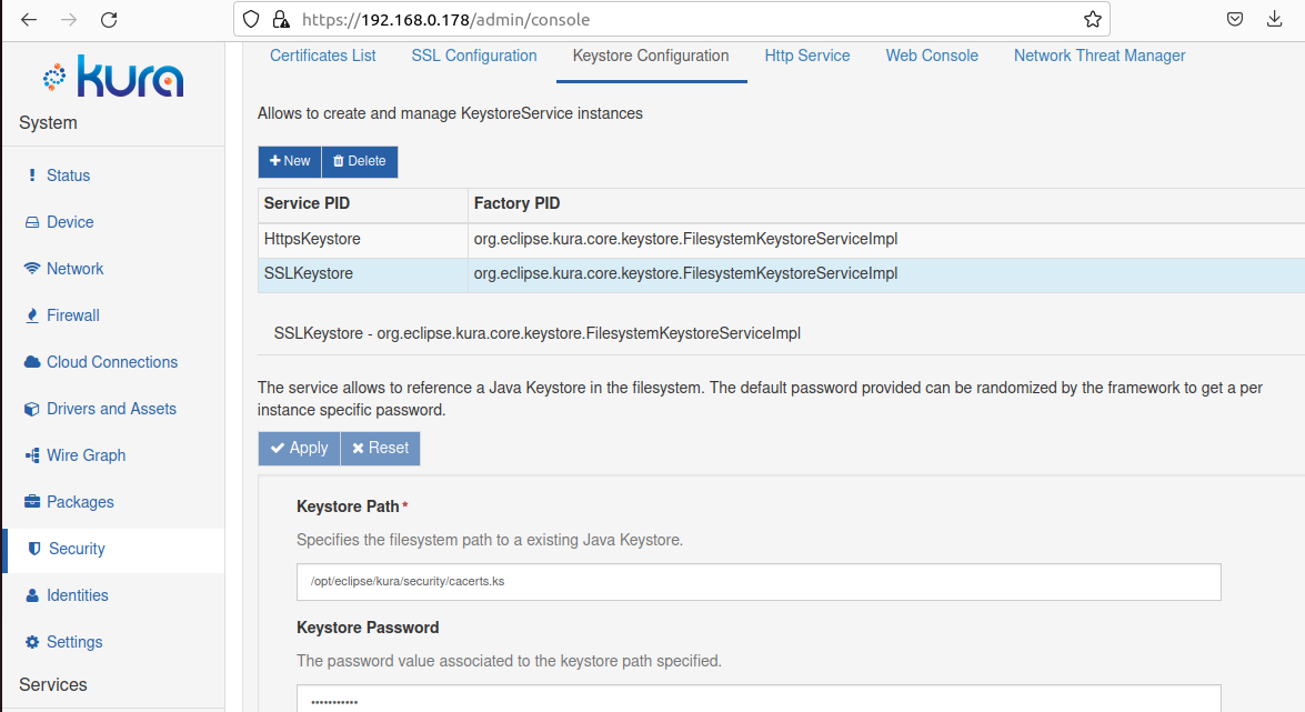

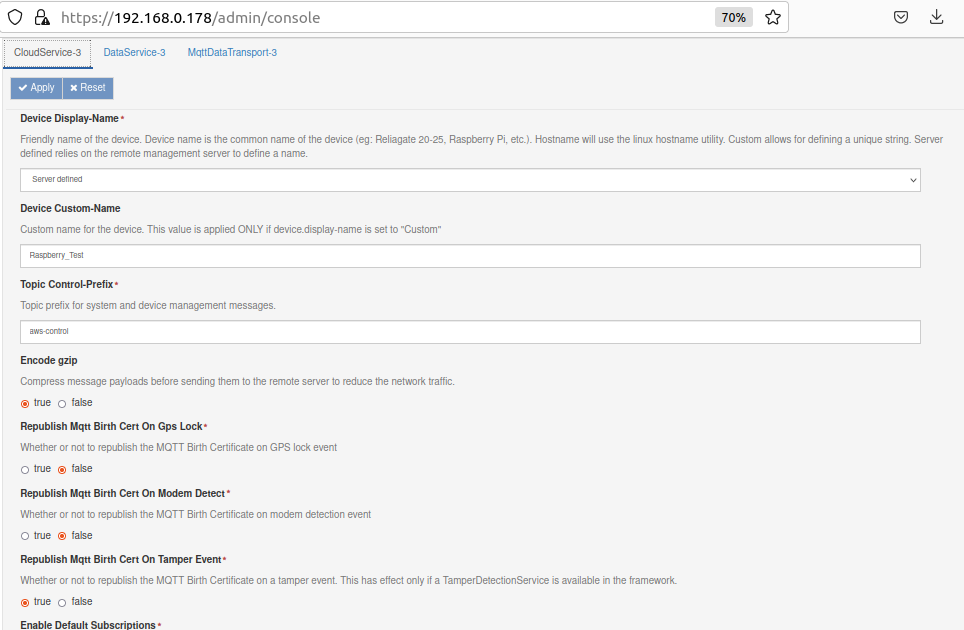

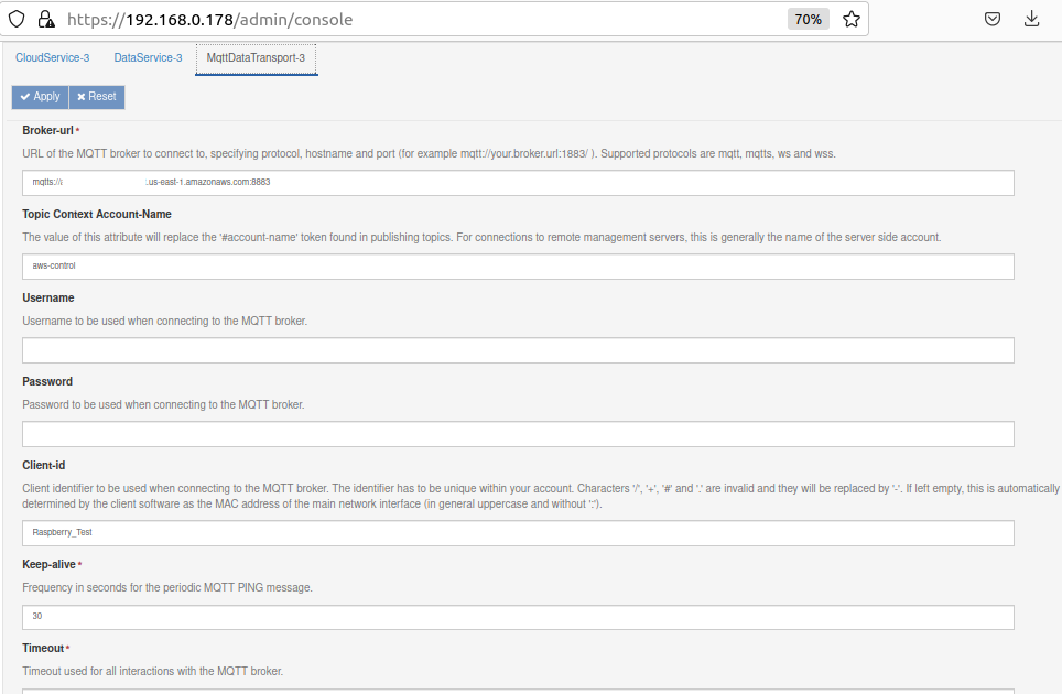

I think I'm sure I set correctly port (8883) and mqtts://, Lwt.retain is set to false, private key is converted to the PKCS8 format.
I use Kura v. 5.1.2.
Screenshots below shows my settings:
index.php/fa/42698/0/
index.php/fa/42699/0/
index.php/fa/42700/0/
index.php/fa/42701/0/
Krzysztof
Re: Cannot connect to AWS IoT [message #1856080 is a reply to message #1855962] Sun, 20 November 2022 12:47 Go to previous messageGo to next message
it seems like the connection has been dropped at the AWS side.
What is the configuration of the thing in AWS?
Matteo
Re: Cannot connect to AWS IoT [message #1856161 is a reply to message #1856080] Wed, 23 November 2022 13:00 Go to previous message
thanks for your answer. I just forgot to attach policy to certificate of my device... Now it works fine.
