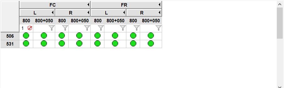

When i apply filter in Nattable, Vertical Scroll bar is appearing with respect to base list with empty rows. Please find my SWT composite creation below and please find the attachments.

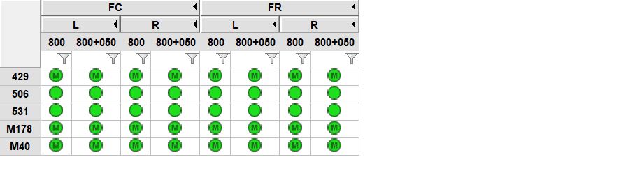

Assume that there are 5 rows initially without filter. Then everything looks good.
Once i apply filter, then 2 rows filtered out, and the remaining 3 rows which are not filtered as empty rows appearing with vertical scroll bar.
