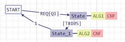

Greetings, I have been stuck in the ECC diagram of the FB block, I wanted to know if it is possible, as in the attached image, to retain a state for a certain time to pass to the other state. Thanks for your reply.

Re: Delay between states in ECC [message #1855560 is a reply to message #1855537] Thu, 20 October 2022 08:17 Go to previous message
Unfortunately IEC 61499 does not directly allow timed transitions. But we provide an adapter interface ATimeOut which you can use for getting timed transitions. An overview can be found in the adapter tutorial: https://www.eclipse.org/4diac/en_help.php?helppage=html/4diacIDE/advancedFeatures.html#adaptersUsage
