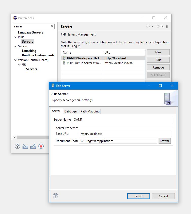

I don't know if automatic detection ever worked for me. I configure the server manually:
index.php/fa/42468/0/
Re: Error to Choose the type of server to create [message #1854796 is a reply to message #1854785] Sun, 11 September 2022 11:10 Go to previous messageGo to next message
Hi, thank you so much to answer.
I try your way, but anyway I doesn't work.
I attached a few pictures so you can see.
Regards Andrea

Re: Error to Choose the type of server to create [message #1854797 is a reply to message #1854796] Sun, 11 September 2022 17:43 Go to previous message
XAMPP expects the files in the XAMPP directory under \htdocs\.
On Windows I create symbolic links from folder \htdocs\ to the eclipse workspace directory (via 'mklink /d linkname target')
For example:
cd path-to-xampp\htdocs
mklink /d project1 c:\users\sirecognizer\eclipse-workspace\project1
Through the symlink, XAMPP 'sees' the eclipse workspace in its htdocs/project1 directory. However, the files are modified in the eclipse workspace.
Please be careful with the symlinks and read the doc!
The project is then called as follows:
http://localhost/project1
