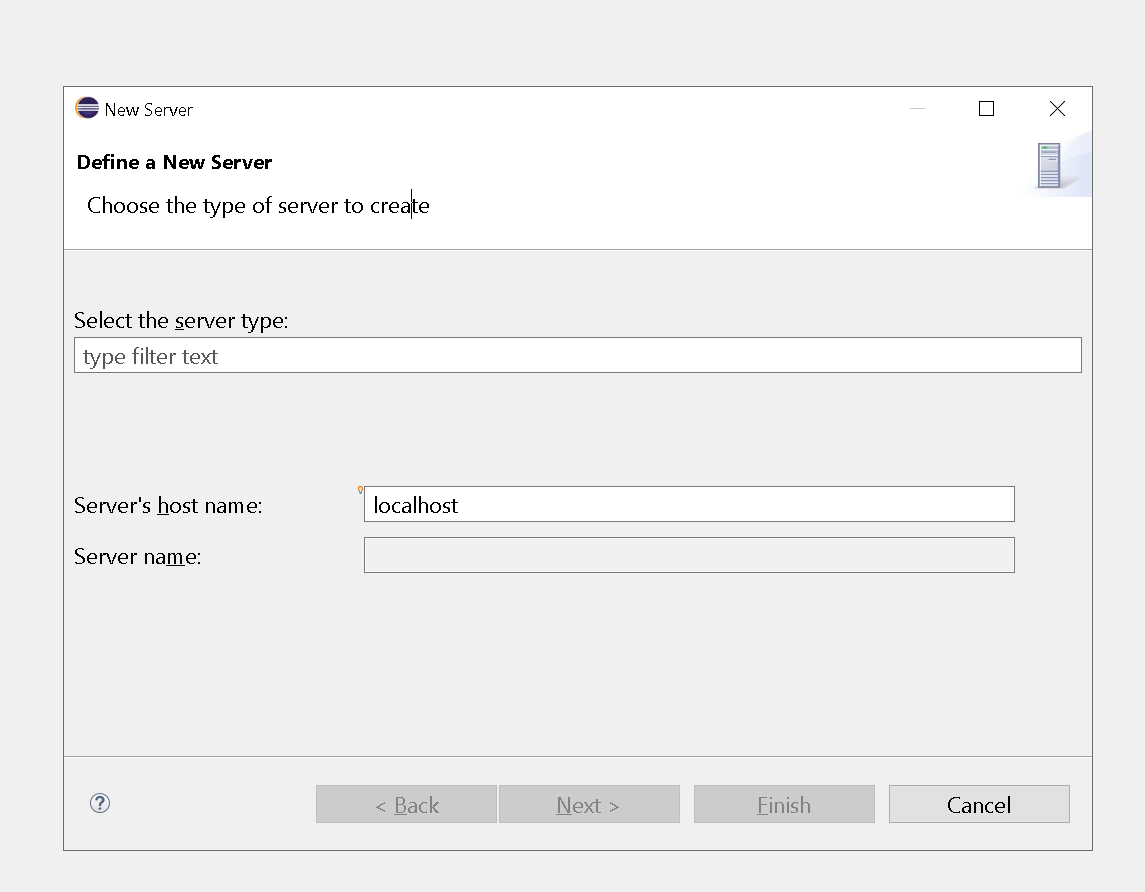

Hi.
My name is Andrea and I have a big issue with Eclipse.
I bought a new laptop with windows ten and I installed Eclipse, the last release.
Before write here I tried everything I could, I read many websites page and many video on YouTube. I tried to install different version of Eclipse, Java, C/C++, PHP. I tried also to install separately, and all together add in help -> install software. I tried to cheek if there are any update available.
I installed the last release of XAMPP and JDK.
However, I still have the same problem when I try to install a server.
I press the botton to install a server and it open a window where there is write "Choose the type of server to create" but there are not servers to choose.
Someone can help me to fix it, please.
Regards Andrea

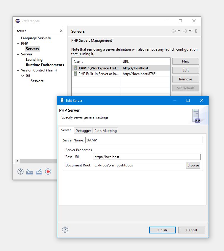

I don't know if automatic detection ever worked for me. I configure the server manually:
index.php/fa/42468/0/

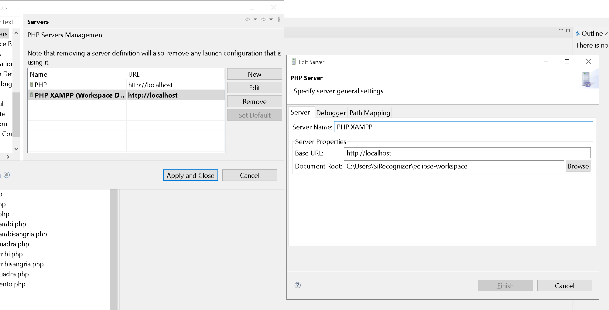

Hi, thank you so much to answer.
I try your way, but anyway I doesn't work.
I attached a few pictures so you can see.
Regards Andrea

XAMPP expects the files in the XAMPP directory under \htdocs\.
On Windows I create symbolic links from folder \htdocs\ to the eclipse workspace directory (via 'mklink /d linkname target')
For example:
cd path-to-xampp\htdocs
mklink /d project1 c:\users\sirecognizer\eclipse-workspace\project1
Through the symlink, XAMPP 'sees' the eclipse workspace in its htdocs/project1 directory. However, the files are modified in the eclipse workspace.
Please be careful with the symlinks and read the doc!
The project is then called as follows:
http://localhost/project1
