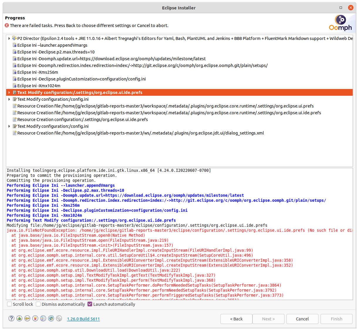

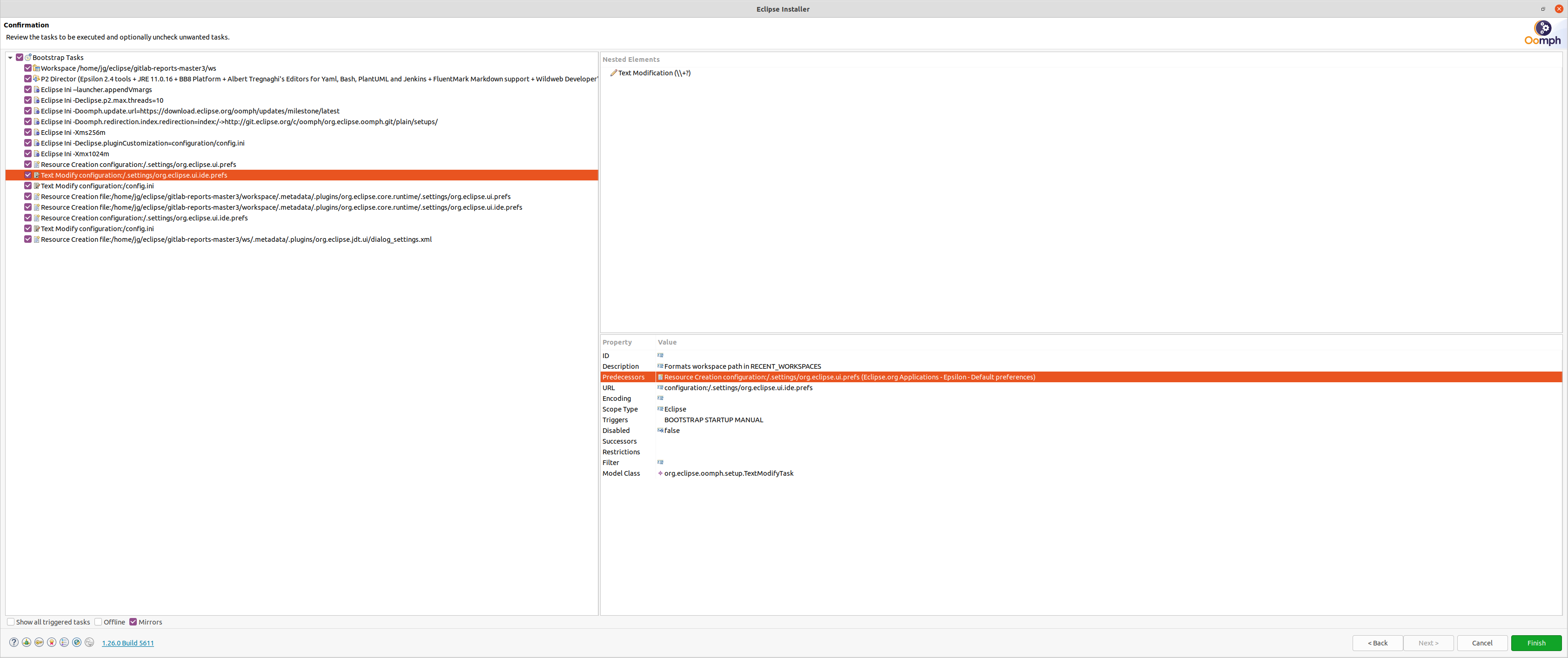

In the attached picture, you can see an installation screenshot of Epsilon 2.4
This installation fails with a file not found because the text modification operation selected
org.eclipse.oomph.setup.TextModifyTask
configuration:/.settings/org.eclipse.ui.ide.prefs
depends on
Resource Creation configuration:/.settings/org.eclipse.ui.prefs (Eclipse.org Applications - Epsilon - Default preferences)
rather than
Resource Creation configuration:/.settings/org.eclipse.ui.ide.prefs (Eclipse.org Applications - Epsilon - Default preferences)
As a result, as can be seen, the Oomph task order solver puts the task in the wrong place.
I am unsure how to report this issue.
Further, I would like to reuse the published 2.4 setup, but I am unsure as to how I can patch this?
Any ideas?

I think I found the issue, which is caused by Reordering.
... when multiple streams are involved, final phase processing is dealing with a concatenated list in which the tasks must be properly reordered. To support that, each task has an intrinsic priority; the task list is primarily sorted according to that priority. Each task also specifies predecessors and successors; the task list is secondarily sorted to respect that induced partial order. After these two sorting steps, the tasks in the list are modified to clear both the predecessors and successors and then the predecessors are set to form a chain that induces an overall order that's exactly this final order of sorted task list; this chain excludes variables. This chain of dependencies ensures that the final phase processing, which deals with the concatenated task lists, will properly interleave the tasks (because of the priority sorting) while also respecting the per-stream order of the multiple streams.
So the cause is pobably that I am reusing Epsilon in a Configuration which also contains a Workspace, which contains a Project with multiple Streams. This prompts the reordering of Tasks. At this point, the natural order in the Epsilon setup is lost, because there is no explicit dependency and the two tasks have the same priority. This means that they come out based on hash order, which can be anything, and in my case is an order that does not work.

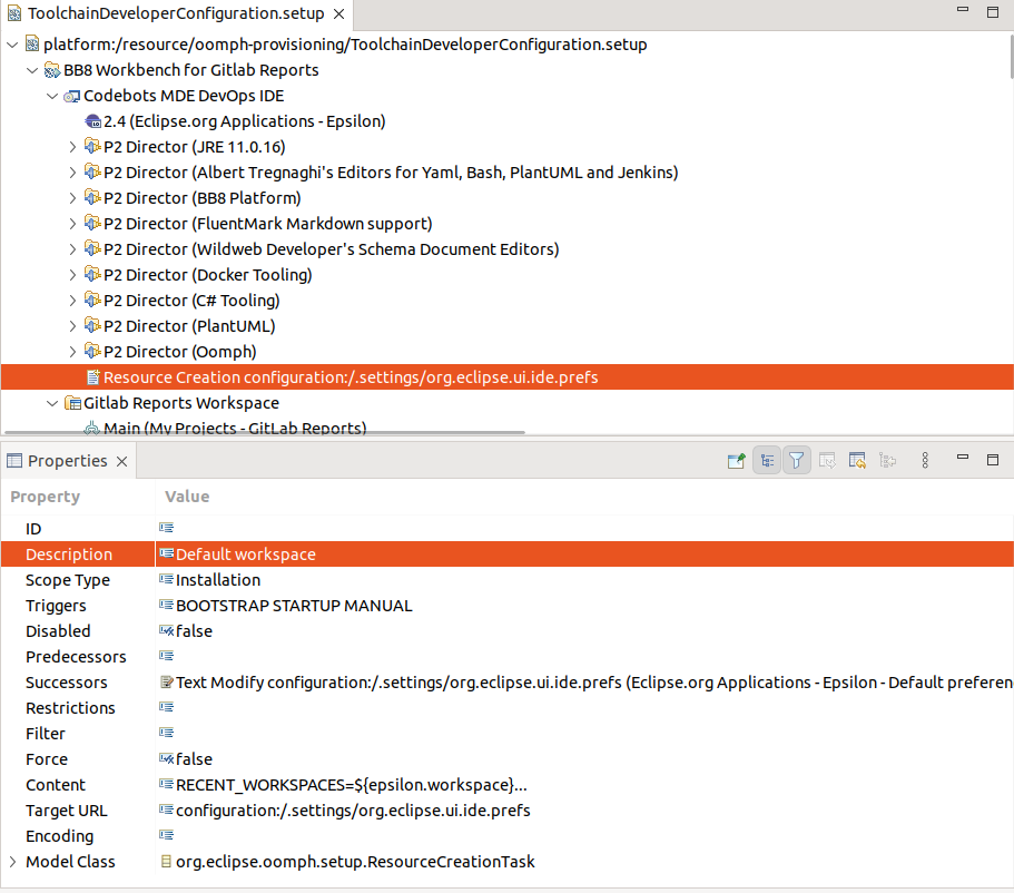

Re: Bug: dependency order in installation [message #1854742 is a reply to message #1854728] Tue, 06 September 2022 21:47 Go to previous message
I have been able to patch the issue. It is caused by the lack of prerequisite order. I was able to fix it by copying the resource creation action into the installation as below and then adding advice about the order. The installer removes the duplicate action, but accepts the order. Important to notice that I had to point 'down'. That is, the creation action needs to have a successor set. I am unsure why this does not work the other way.
