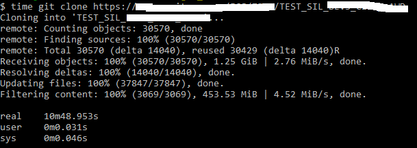

We are seeing very slow cloning times when using Git Clone Wizard versus Git command line.
For example, to clone one of our repos takes about 11 minutes using Git command line and about 137 minutes using Git command line.
There appears to be no difference in the cloned repos using the different methods.
It appears that Git Clone Wizard is performing different steps to clone versus Git command line.
The steps for Git command line can be seen in the attachment.
index.php/fa/42384/0/
It's not clear what steps are being performed using Git Clone Wizard. However, I do see it's performing "Checking out files:" which is what is causing the very long clone time.
What can be done to get Git Clone Wizard to perform as well as Git command line?

It looks like you use LFS, and have 3069 LFS files. C git has delayed smudge filtering for such files: the LFS filter can return immediately with status "delayed", and the file is skipped for the initial checkout. LFS then continues in the background to download the (large) file. Once all normal files have been checked out, git then re-tries to get these "delayed" files. This essentially parallelizes downloading LFS files.
See "Long-Running Filter Process" in the C git documentation.
JGit has no such mechanism, its built-in LFS smudge filter is synchronous and downloads one LFS file after the other during check-out.
I suspect that this accounts for most of this time difference.
