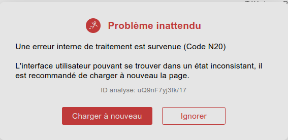

The exception message is shown in the attached image. It's in French, but tit says an internal processing error occurred with error code N20.
What you are seeing is the NullPointerException caused by the error transformation, not the original error. Try setting a breakpoint and inspecting the content of the ErrorResponse object.
