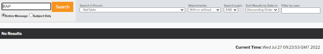

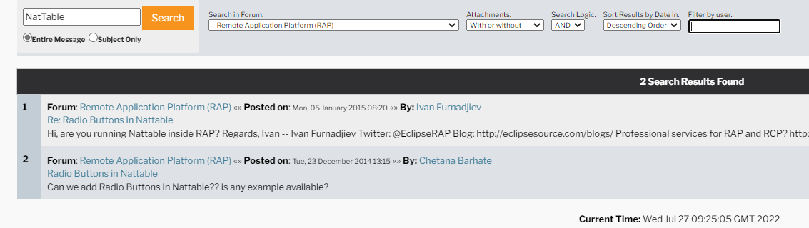

I've queried the forum about already existing topics, but I didn't found duplicates (neither in NatTableindex.php/fa/42343/0/ nor in RAP index.php/fa/42342/0/).
I not certain about this is a topic for NatTable or for RAP so I will also create a topic under RAP forum?!
My question is: are there plans to support NatTable under RAP? Plained used it is drawn as canvas (we tested with NatTable version 1.6) with all resulting behaviour.
