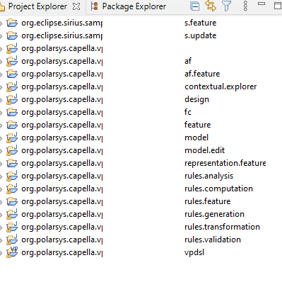

Hello Glenn,
All my sirius programming was done though Sirius SPECIFIER, I did not have to touch the code at all except for some aql code inside the specifier interface.
Do you know where I could find the codes you mentioned in my explorer (see image attached)
Other than that, I found a solution, you have to select a base default value, this will replace the multiple clicks the user has to do. It's not perfect but it did the trick.

Could you tell me more about your (CheckBoxPropertySection class) ?
How are you developping?
You start from the eCore than start programming?
