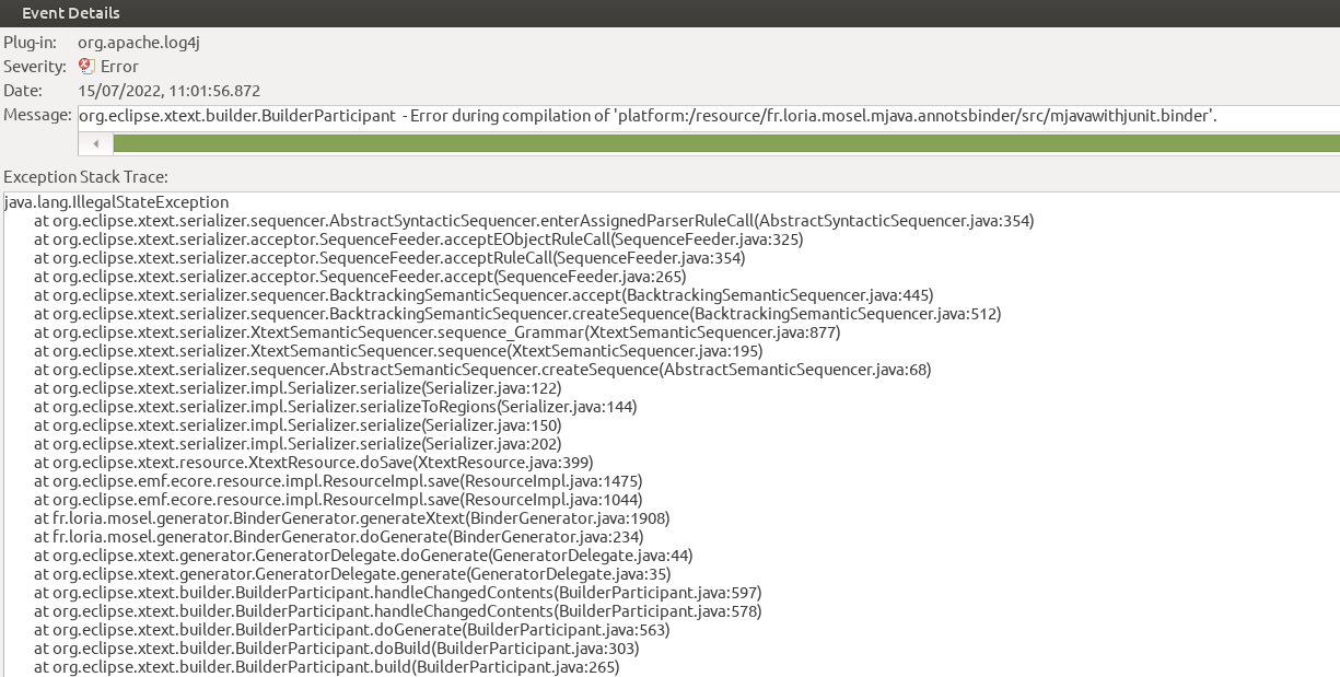

My various attempts always fail when it comes to using the save instruction from the XtextResource (log error in screenshot below).

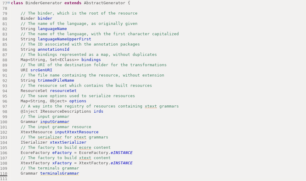

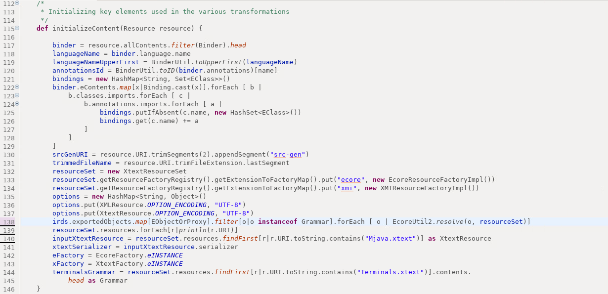

Here is the constructor in wich you can see how the serializer is created starting from line 132:
index.php/fa/42315/0/
index.php/fa/42316/0/

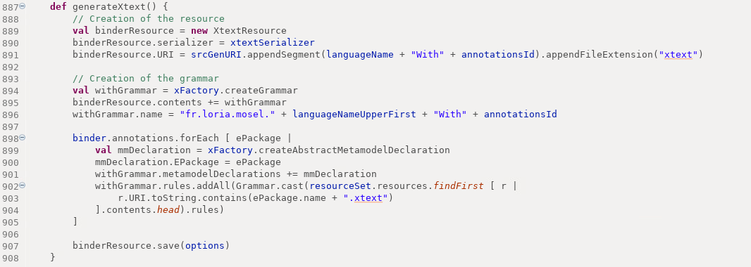

Here is how I generate the new Xtext Grammar using the previous serializer and options:
index.php/fa/42317/0/
Here is the log error printed when trying to run it:
index.php/fa/42318/0/

The code looks very strange
Normally stuff is created using injectors and not using new
