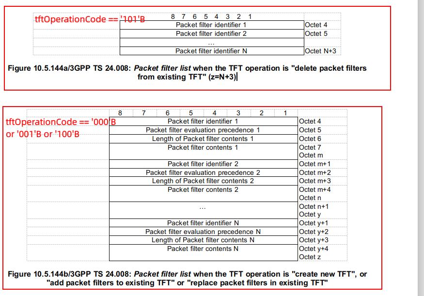

here is the struct
type record TrafficFlowTemplate {                             /* 24.301 cl. 9.9.4.13 -> 24.008 cl. 10.5.6.12 */
  IEI8_Type                   iei                   optional, /* present in case of TLV; omit in case of LV */
  Type4Length_Type            iel,
  B3_Type                     tftOperationCode,
  B1_Type                     eBit,
  B4_Type                     noOfPktFilter,
  record of PacketFilter      packetFilterList      optional,
  record of TftParameter      parameterList         optional
type record TftParameter {
  IEI8_Type                   iei,
  octetstring                 contents
type record PacketFilter {
  IEI8_Type                   iei,
  B8_Type                     precedence            optional,
  Type4Length_Type            iel                   optional,
  PacketFilterContents        contents              optional
type record of PacketFilterComponent PacketFilterContents;
type record PacketFilterComponent {
  O1_Type                     id,
  PacketFilterComponentValue  packetFilterComponentValue
type union PacketFilterComponentValue {
  O8_Type    ipv4RemoteAddress,
  O32_Type   ipv6RemoteAddress,
  O1_Type    protocolIdNextHeader,
  O2_Type    singleLocalPort,
  O4_Type    localPortRange,
  O2_Type    singleRemotePort,
  O4_Type    remotePortRange,
  O4_Type    securityParameterIndex,
  O2_Type    typeOfServiceTrafficClass,
  O3_Type    flowLabel
if tftOperationCode == '000'B or '001'B or '100'B or '101'B, PacketFilter is presence, but there is a little difference, show in the 1.jpg
and the noOfPktFilter indicated the count of PacketFilter(attention: not the length of it)
you can neglect the decode of TftParameter.
then what should I do can decode the packetFilterList
Thanks a lot!!
