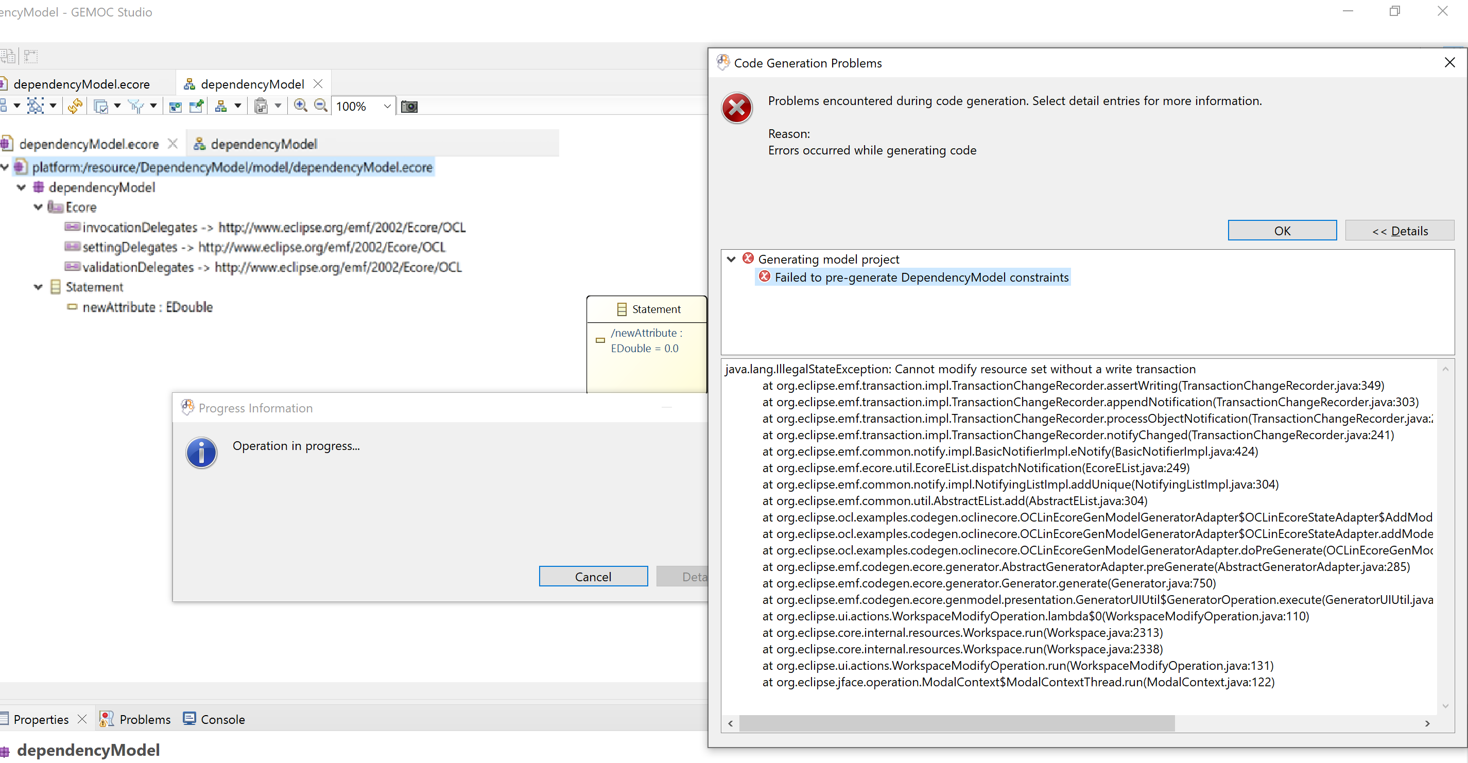

I used Ecore OCL within my Ecore modelling project for calculating a derived attribute in one of my projects.
Everything worked fine until about a month ago, but now I keep getting an error when doing code generation for the Ecore project stating "Errors occurred while generating code." The details are in the attached file.
Can you please help me resolve this?

Please ask OCL questions on the OCL forum / Papyrus questions on the Papyrus forum.
What you have presented is impossible since Eclipse OCL makes no use of EMFt and so the cannot modify without a write transaction cannot occur.
However you provide only a PNG rather than a full stack trace, so we cannot see what, presumably Papyrus, is part of the trimmed trace.
If this really is a use case that once worked, my best guess is that either Papyrus or OCL has evolved so that a Papyrus ResourceSet configured for EMFt is now exposed for re-use.
You therefore need to accurately report your use case and the versions that work and those that do not.
(OCL has been evolving and now uses a ThreadLocal rather than a ResourceSet adapter to cache the OCL context for which EMF provides no passing mechanism. It is possible that a sequence of two actions has passed something unhappy between OCL sessions. However that would imply that OCL was being invoked on the main rather than a worker thread, which would be a very bad practice. Looking at the PNG again, it might not be trimmed, it may be a worker thread as expected, so conversely if you are using an older version of Eclipse OCL, you may be demonstrating why I moved from a ResourceSet adapter that could share across threads in embarrassing ways to a Thread Local that cannot.)

Thank you for your detailed reply, Ed.
I would like to note this was not an OCL-related question and neither a Papyrus one.
I was using GEMOC Studio (not Papyrus) and thought the EMF are used in a straightforward manner, but it seems I was wrong and it was indeed the GEMOC platform that introduced a bug. I tried my design with native Eclipse and it works just fine.
