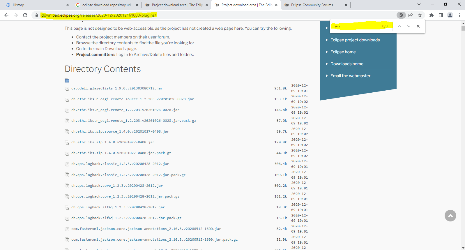

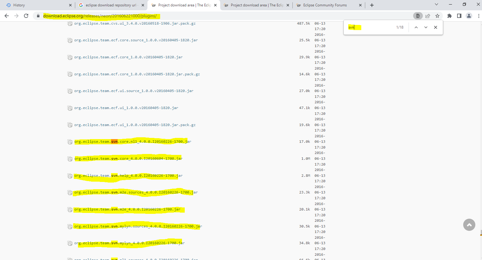

For our eclipse rcp project . We are migrating from the eclipse 4.8 Neon-> Eclipse 4.18 version
We are using the p2 repo url http://download.eclipse.org/releases/neon to download the plugins and one of the core plugin we are using with this version is the svn related plugins eg: org.eclipse.team.svn.core etc
During our migiration, in the version 4.18 we are using the url https://download.eclipse.org/releases/2020-12/ and same under plugin we were unable to find those svn related plugins. we are blocked at this point because our application tries to download the dependent svn plugins from the URL https://download.eclipse.org/releases/2020-12/ and hence it is not found
Could you please suggest some solution? is it possible to migrate to the version 4.18? where i can get those svn related plugins
I have attached the screenshot as well for the refrences
