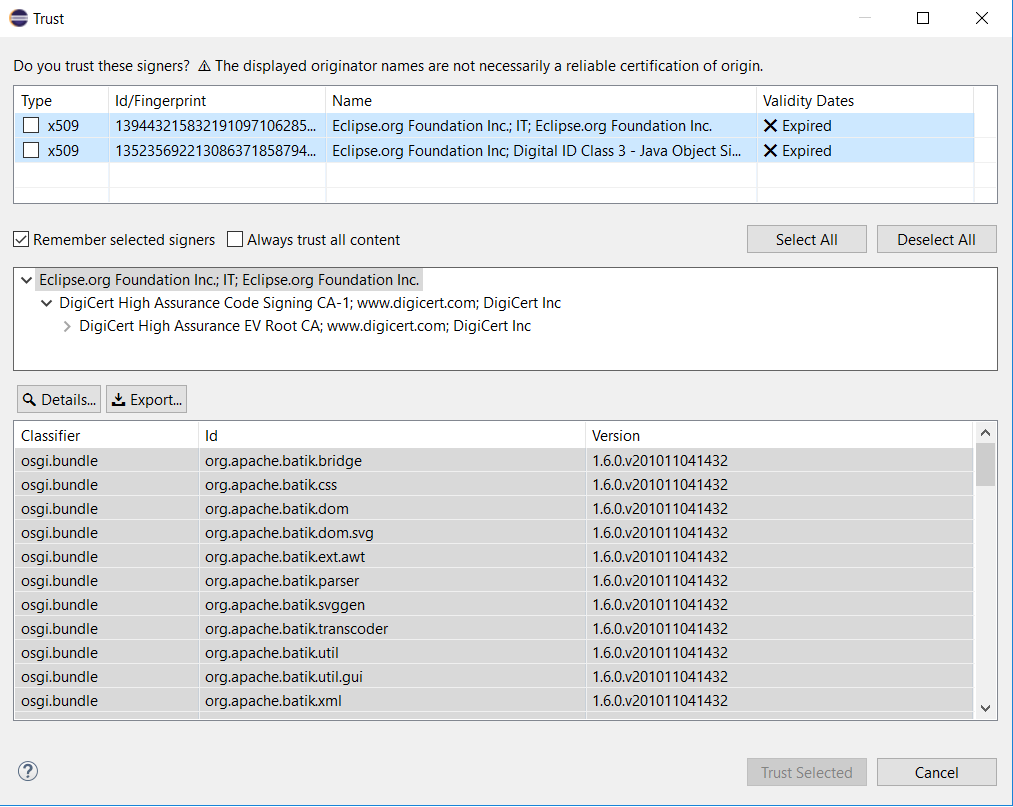

Do you know if there will be an update for GMF Tooling?
We are using Eclipse 202206 with Apache Batik* plugins version 1.14.0, but when GMF Tooling is installed (3.2.1 /3.3.1.a version), it overrides the Apache Batik* plugins version with an older version of 1.6.0.
This causes conflicts because some features like BIRT look for Apache Batik* plugins with version 1.7.0 or 1.14.0.
Thank you!
