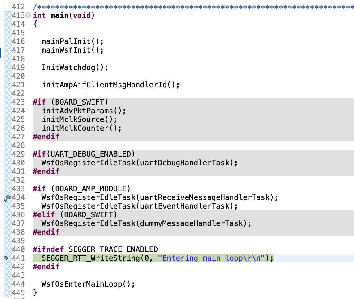

main.c is shown here:
index.php/fa/42139/0/
The breakpoint on line 434 that had no effect. Lines 434 and 435, while showing as active code on-screen, did not actually get compiled. Eclipse moved the breakpoint to the next valid line of code on line 441 as highlighted.

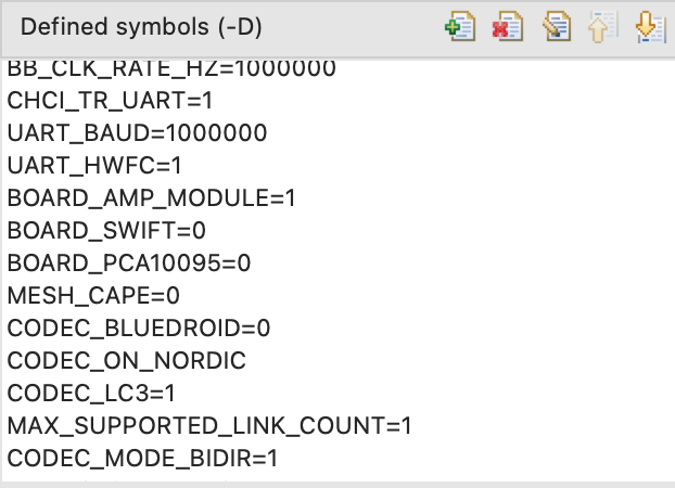

The PP symbols at the project level are:
index.php/fa/42140/0/
PP symbol BOARD_AMP_MODULE is active and this is reflected on-screen.

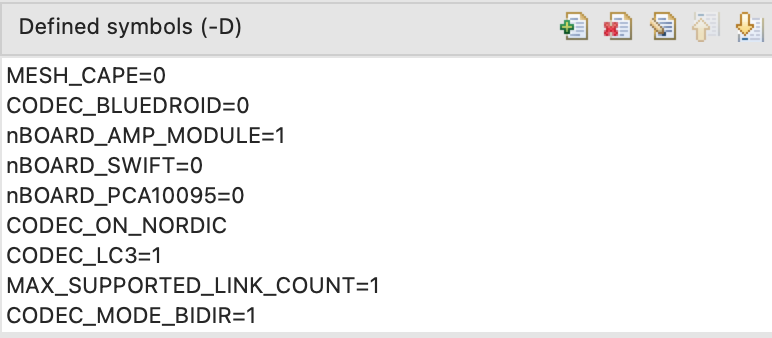

PP symbols at the main.c file level are:
index.php/fa/42141/0/
PP symbol BOARD_AMP_MODULE is "commented out" (or completely removed) but Eclipse is interpreting that as being not defined instead of referring to the project-level PP symbols.
The index has been rebuilt (multiple times) but Eclipse is still looking at the file for the BOARD_AMP_MODULE symbol, doesn't find it and doesn't compile the bracketed code segment. Meanwhile the parser that greys code segments out is looking at the project level PP symbols.
