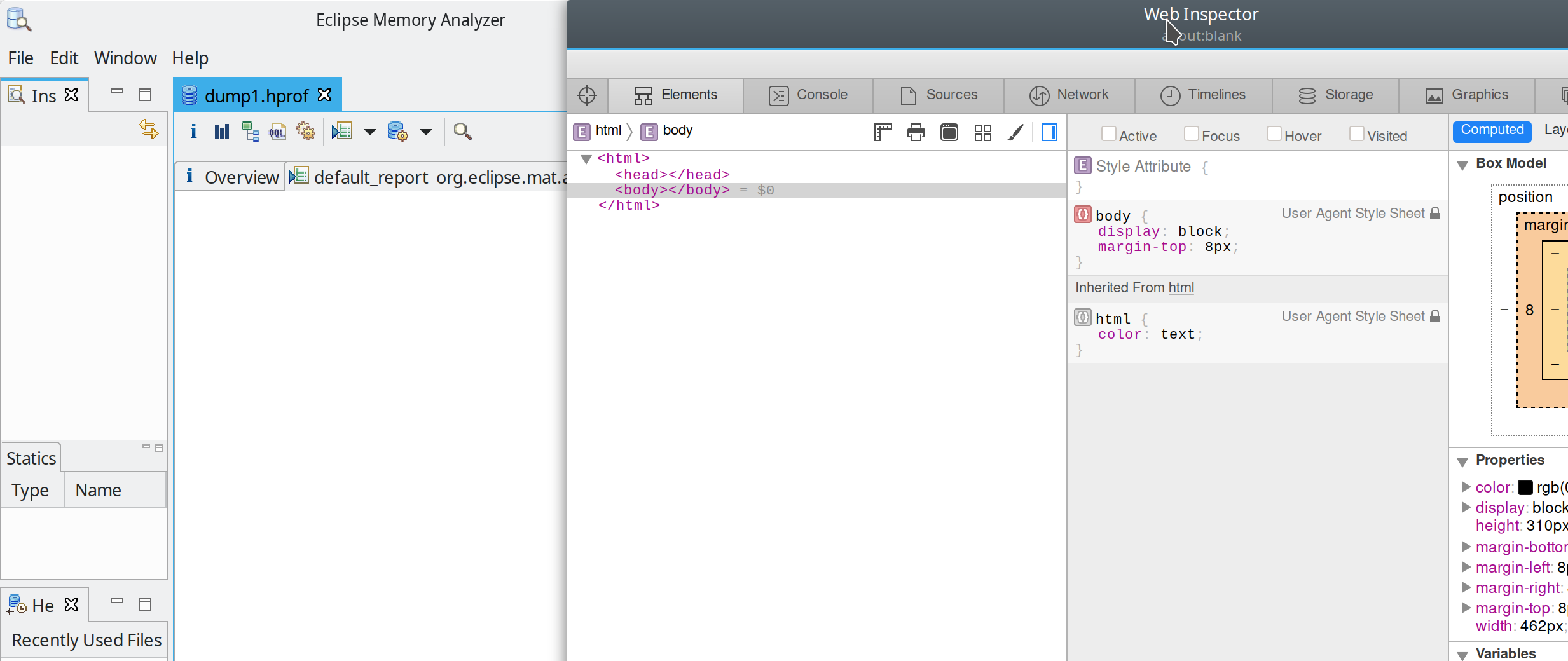

The tab where report should be displayed can be inspected and looks like this:
index.php/fa/42121/0/
The following messages are logged:
