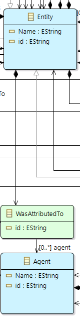

So, I have a quite complex metamodel on which there are some Element Based Edges. I'll post a picture of one of them here and if any of you guys could help me figure it out how to make it work, I think I can follow the process to the other edges.
This is a piece of my metamodel, defining that one Entity can have a WasAttributedTo relation with "n" Agents:

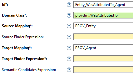

And this is how I was trying to do. I know it's incomplete, but I need help to understand how to access the Entity from the WasAttributedTo class.

Your configuration seems correct, though incomplete.
You need to add:
* "Semantic Candidates Expression": an expression that returns the instances of WasAttributedTo that should be actually displayed on your diagram. It can be all of them, or just a subset based on some criterion, it really depends on what your diagram is designed to show. From your metamodel it seems these are owned by Entity, so probably somehting like "aql:theSameExpressionYouUsedForThePROV_EntityMapping.theNameOfTheContainmentReference"
* "Source Finder Expression" and "Target Finder Expression": given one instance of WasAttributedTo returned from the previous expression, how does Sirius find which elements the edge should connect? Assuming the source is the Entity and the target is the Agent, the expressions should probably be: aql:self.eContainer and aql:self.agent
Also note that an edge will actually be displayed only if the configured source and target nodes are actually displayed on the diagram. If for some reason the Agent returned by aql:self.agent does not have a corresponding instance of PROV_Agent visible, no edge will be created (it would have nowhere to point to).
