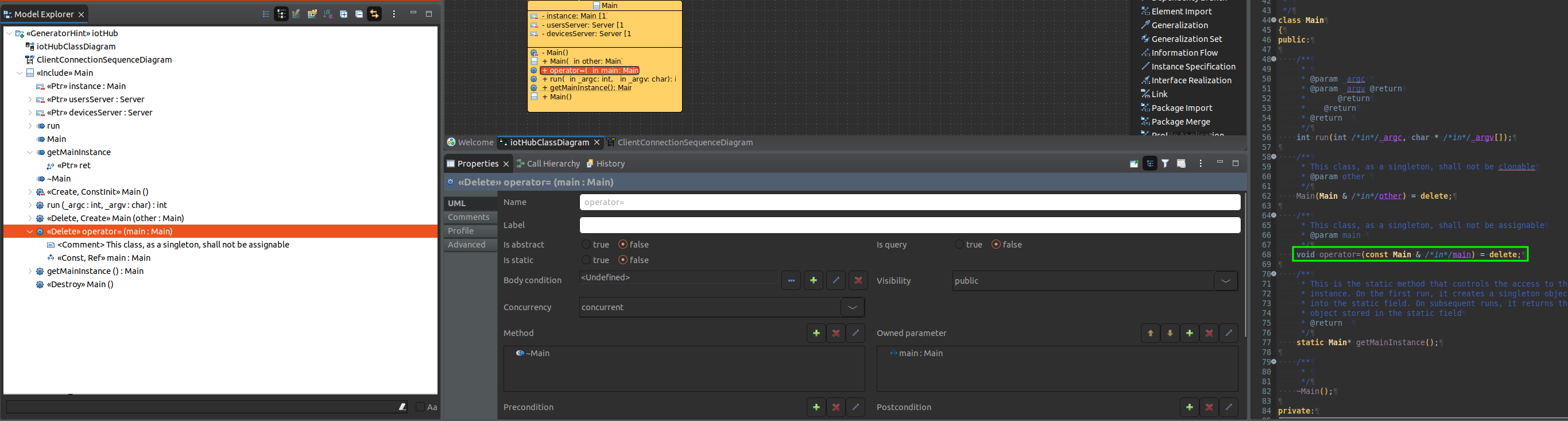

So far so good. The deleted assignment operator overloading is created successfully and everything looks good. Bu then the declaration changes as soon as I hit "save". It is changed for this:
index.php/fa/42066/0/
BUT! The code in Main.h is still the same. I would be ok if I didn't execute a "(right click) > Designer > Generate code" but that sometimes is necessary at some point and that would screw up my code because that unintended change in the diagram would propagate to the code.

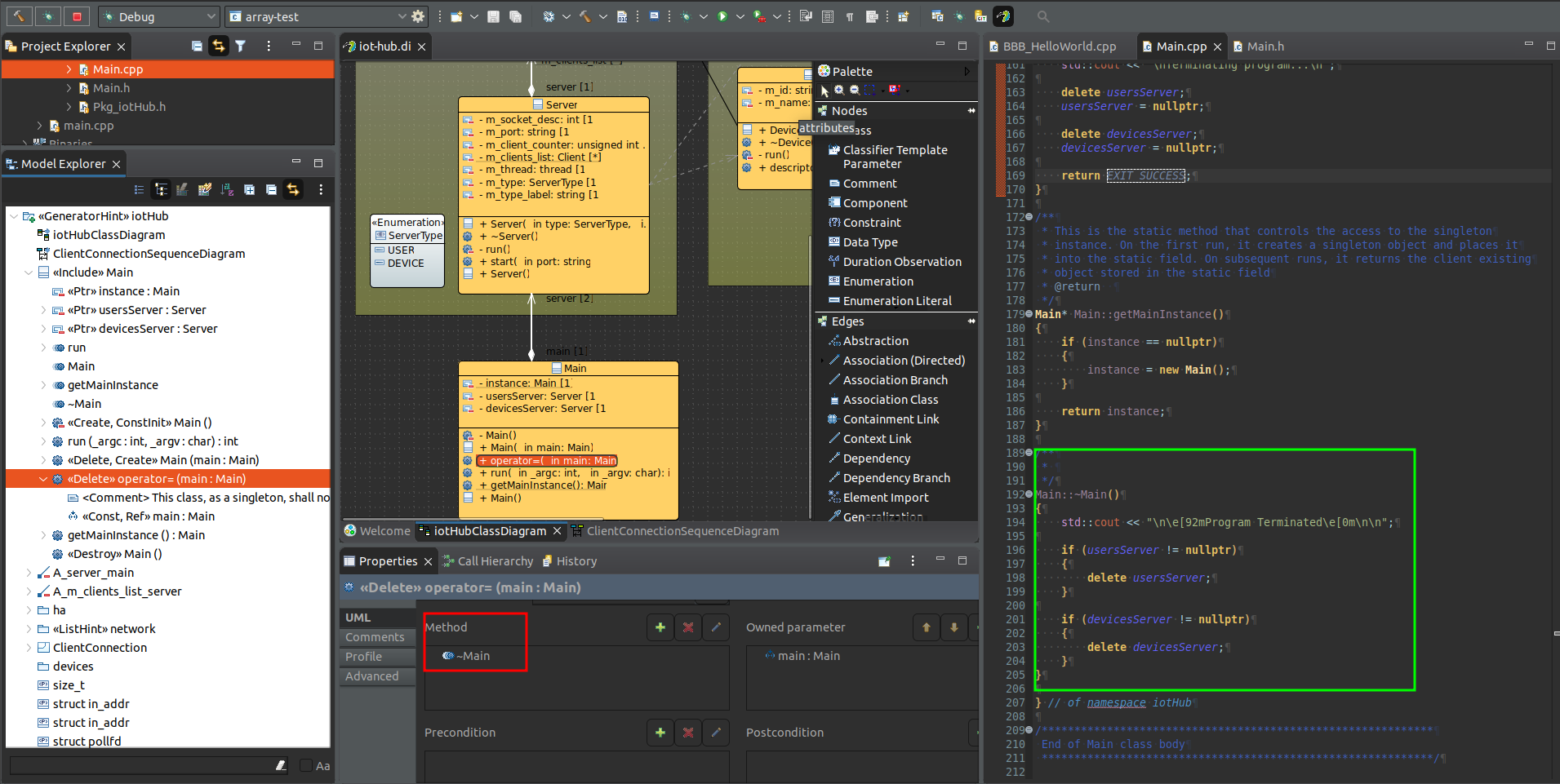

Thank you so much for helping! Thanks for noticing that! Although, even if I remove the ~Main behavior from the methods, it gets changed when I save the model. Here is how to reproduce it on the attached project:
1- Open the project and have the arrangement of the windows similar to the sample images. You will see first that the operator= references the ~Main method and please notice the correct implementation of ~Main on the Main.cpp file
index.php/fa/42168/0/

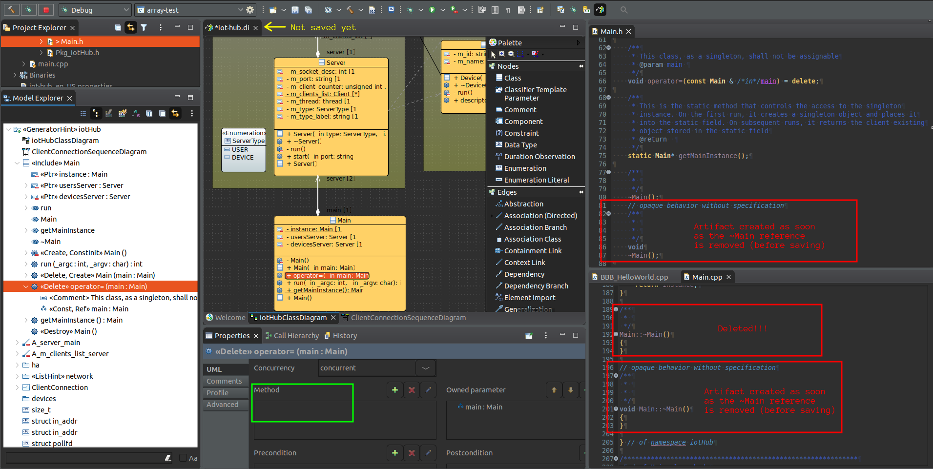

2- Remove the ~Main method from the operator=. As soon as you remove the method this happens.
* - The correct implementation of ~Main on the Main.cpp is deleted leaving and emtpy ~Main.
* - A strange artifact appears in both Main.cpp and Main.h files
index.php/fa/42169/0/
3- This persists and nothing changes even after saving the .di file.

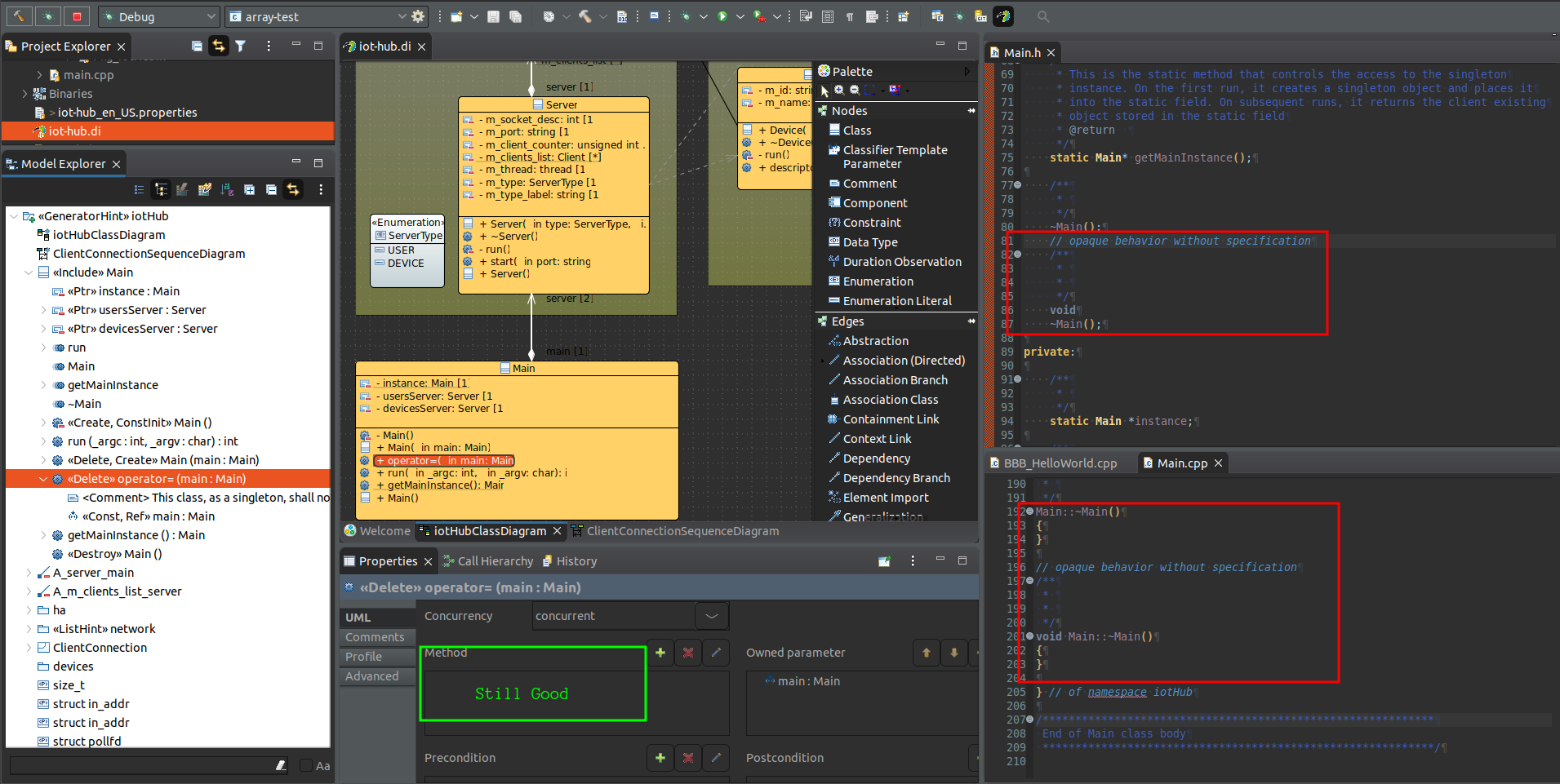

4- Go to both Main.cpp and Main.h files and press ctrl+z to recover the original implementation of ~Main and save the files. So far so good.
5- The problem appears again if you perform a Designer > Generate code, (as I sometimes would have to do). After generating the code, the correct implementation of ~Main on the Main.cpp file is deleted and the wild artifacts appear again.
index.php/fa/42170/0/

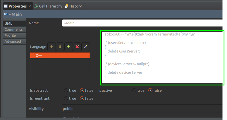

I just have one more observation though. After adding the correct specification to the ~Main behavior and the code was not automatically changed anymore the only issue I still had was the Main::~Main() method code was still being erased. The way I solve this was to paste the code in the C++ text box from the behavior properties as shown here:
index.php/fa/42231/0/
I guess that's fine because now everything works well but I just wanted to ask, is this required? Shouldn't I be able to just normally type the code in the CDT editor and save the file as opposed to write it, copy it, and paste it in the properties window in order to not have it deleted when I execute Designer > Generate code>?
