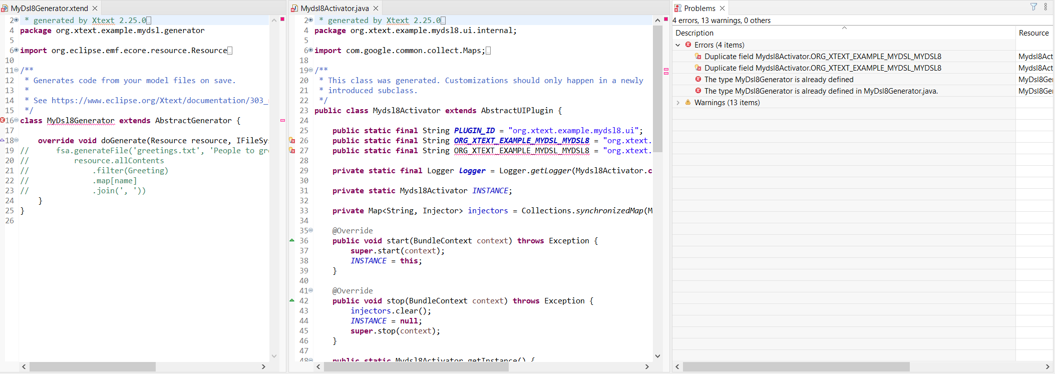

Hi again,
sorry, I also get these errors.
index.php/fa/42024/0/
Thanks.

455 [main] INFO text.xtext.generator.XtextGenerator - Generating org.xtext.example.mydsl.MyDsl8
1172 [main] INFO text.xtext.generator.XtextGenerator - Generating org.xtext.example.mydsl.MyDsl8
i see
// automatically generated by Xtext
grammar org.xtext.example.mydsl.MyDsl8 with org.eclipse.xtext.common.Terminals
and
so name is the same

The thing is that I changed this, and now I see in the log the language is generated. However, the second language with file extension = mydsl9 is not working. It is very weird because when I create a file with this extension the Eclipse does not give me the option to put the "Xtext nature", so I have to put this manually. Any idea why this might be?
If you will like to take a look, please find attached a minimal example. The plugins folder has the Xtext grammar and the Ecore, and the runtime has an example project.
Thanks again!

Be very very careful about copying Xtext examples. The magic Xtext index remembers things and you can have the magic behaviour that you starting executing new/my.mwe2 which finds an internal name to look up and so can continue by executing old/my.mwe2.
I couldn't believe this once I discovered it, but it explained a lot and now I always do whatever I can to avoid the Xtext index.
Bottom line, when copying, change absolutely everything, and close and at least temporarily delete the original to ensure that it cannot be helpfully / very confusingly re-used.

it looks like you did not merge plugin.xml_gen to plugin.xml

Thank you both! Indeed @Cristian I did not merge the plugin.xml_gen to plugin.xml. After doing this it works perfectly.
