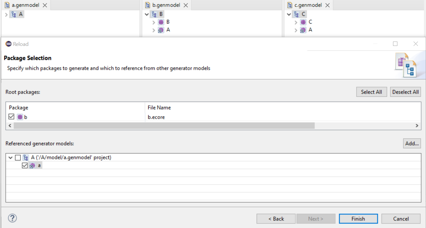

Re: Unable to define multiple child creation extenders [message #1851951 is a reply to message #1851950] Fri, 22 April 2022 11:37 Go to previous messageGo to next message
When you do Reload.. from the context menu, on this page, you should choose packages from the other models. But your models are pretty messed up with the generation you did in the bad state which make it look like 'a' could also come from genmodel 'c'. It should be done like this and look like this:
index.php/fa/42009/0/
If the choices aren't there, use the Add... button to load the other *.genmodel.
Re: Unable to define multiple child creation extenders [message #1851952 is a reply to message #1851951] Fri, 22 April 2022 11:51 Go to previous message
Thank you so much! I had no idea I could edit the genmodel to set the dependencies as references, it makes so much more sense now. I used to be able to extend the children without child extenders properties checked properly because the model was being copied and now it works as expected.
