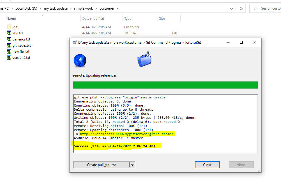

I have been making a local git server by using jgit . Following is my code repository for local git server.
https://github.com/masumcse1/mygitserver
https://github.com/masumcse1/mygitserver/blob/main/src/main/java/org/meveo/api/git/MeveoGitServlet.java
git clone http://localhost:9090/mygitserver/git/customer
This program is working for all type basic git command (clone , push , pull). Now i want to send custom error from this servlet after pushing wrong file (other than .java file) from any user .
User will receive this error message from his git client . any one please explain how can i send this error for git client after push any thing wrong file type.
