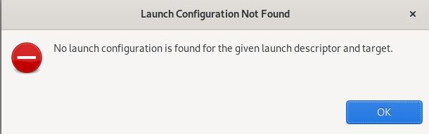

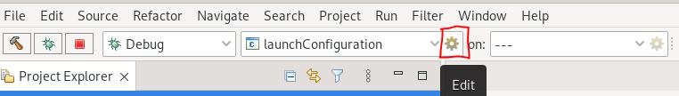

I create a RemoteC++Application-LaunchConfiguration. After creation, further editing is not possible.
index.php/fa/41862/0/
I get the following error message:
No launch configuration is found for the given launch descriptor and target.
index.php/fa/41863/0/
Why can't I open the LaunchConfiguration-Window to edit again?

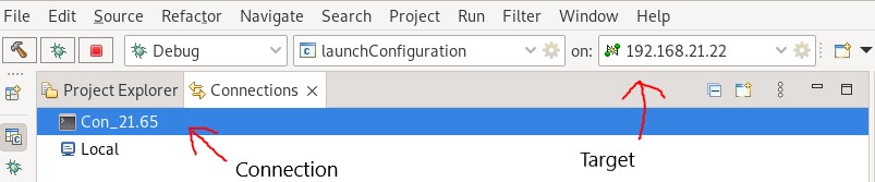

I found out if a Target is defined, I can edit the RemoteC++Application-LaunchConfiguration. However, this Target has nothing to do with the ethernet connection. I gave the created Target a fictitious IP address (192.168.21.22). My device has the Ip address 192.168.21.65.
Why is it necessary to create such a Target?
The IP address for remote debugging is obtained via the Connections!
